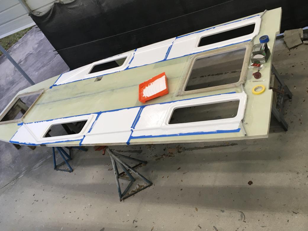

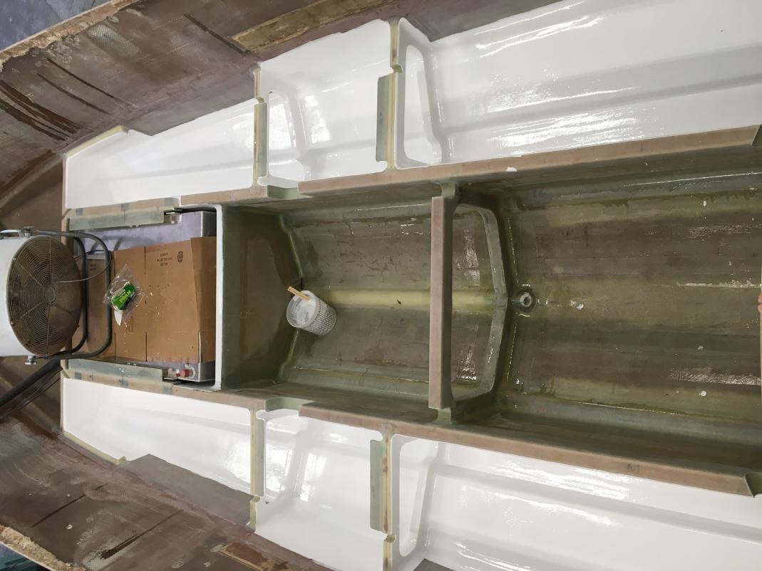

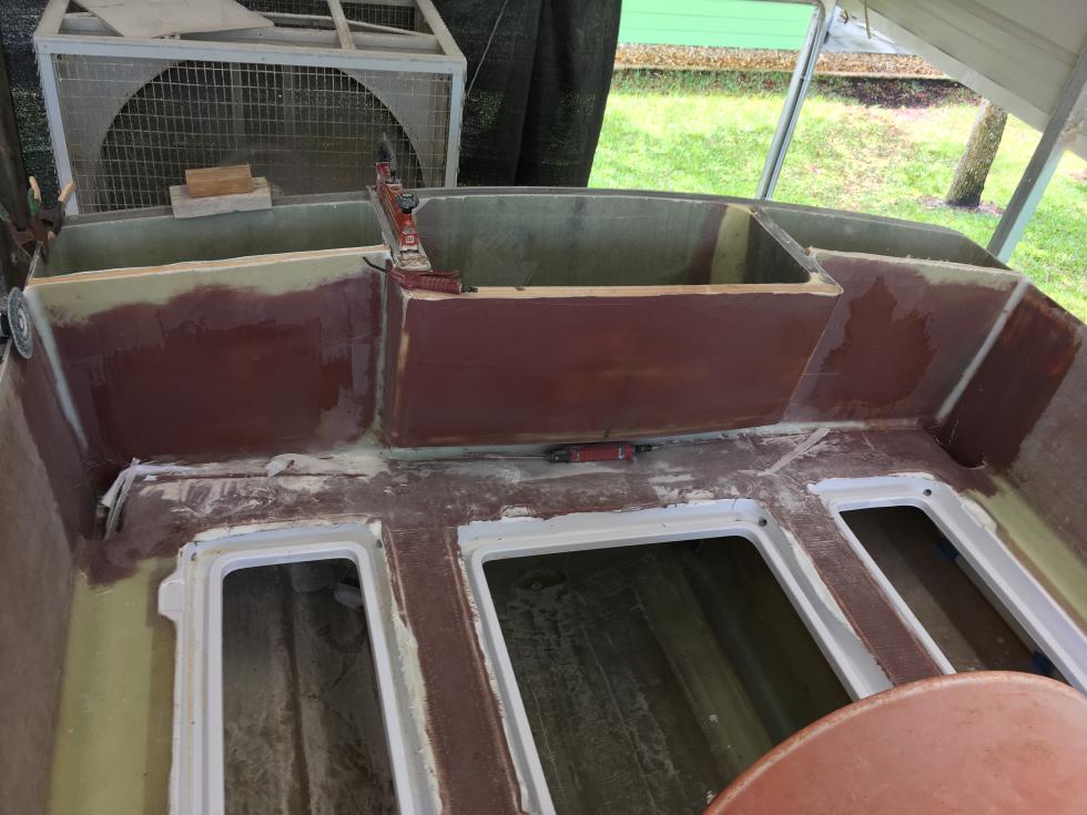

Not much visually different but thatll change when the cap/deck gets laid up...
Sideboxes will serve as bilge ventilation (the bottoms are totally open to bilge), rigging chases, place for speakers, midship cleats, etc..

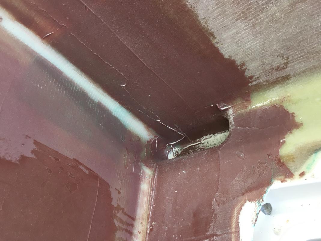

If theres fairing compound on it, it was done wet on wet after glassing. Such a time saver!

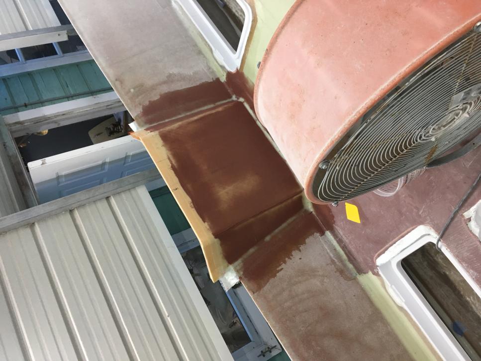

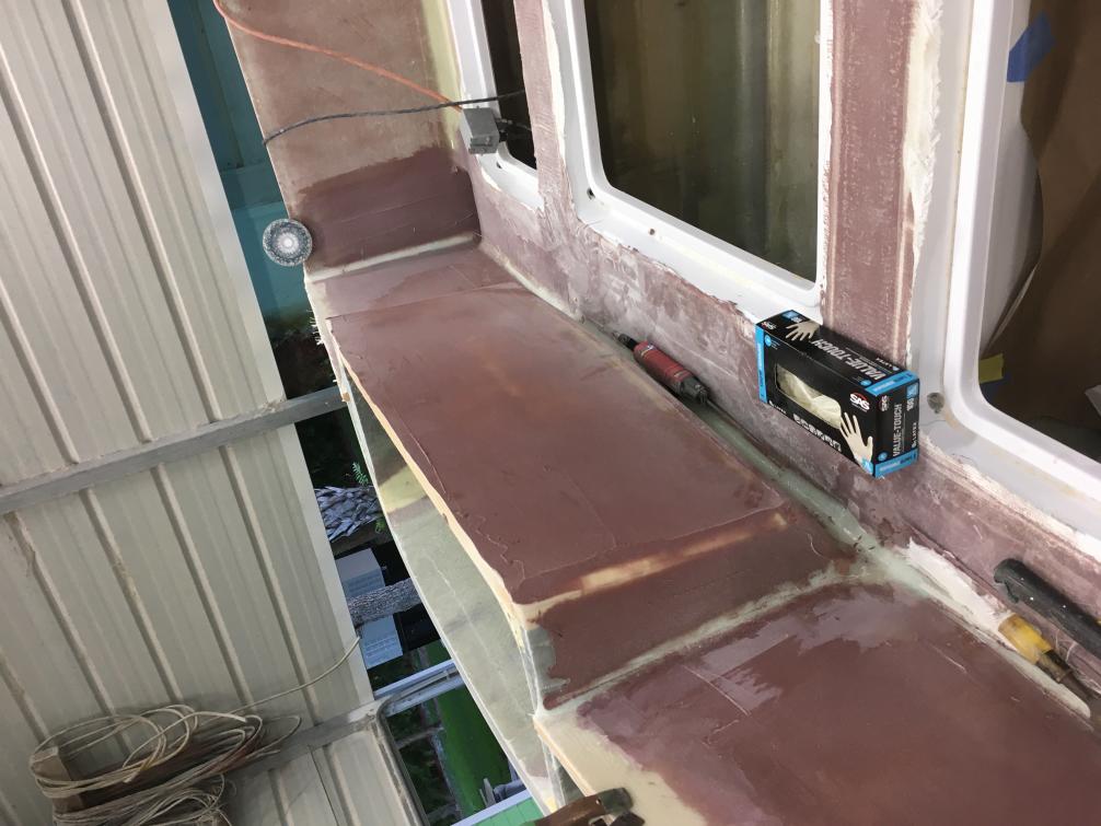

Dirt; so you lay down your last glass and immediately take some fairing compound over it, good idea cuts down on sanding in between! What instrument do you prefer to lay down the compound and what kind of fairing compound do you like?
  #59
Old 04-16-2022, 09:06 AM
Join Date: Jun 2011
Location: St. Lucie county FL
Posts: 437
I wait an hour or so and let the layup gel so the glass doesnt move around. I just use metal blades, 12 & 6 inch. Never been good with the plastic ones, hell im not very good with the metal ones either. Thats just an end of the day preliminary slop-on...
Ill switch to awlfair for everything else. The stuff i make is just cabosil and microballoons, with an emphasis on the microballoons.
