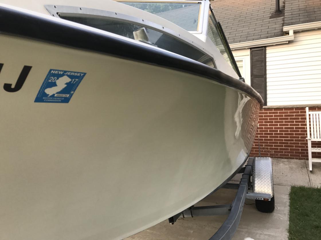

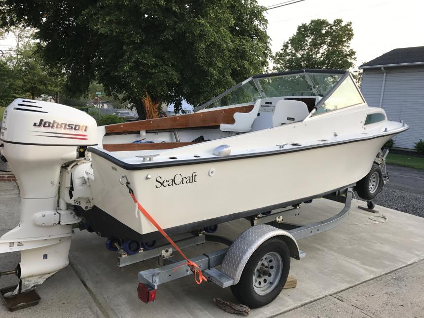

Default Rub Rail Renewal
Well, despite the temperatures soaring into the upper 90's yesterday, my sons and I tackled the rub rail installation. We went with basic black semi-rigid from Taco and it went on reasonably well. At first I was stressing about the exact placement of every screw so as to keep as straight a line as possible, but found that stretching and clamping the base made it easier to make it straight as well as move faster.

Old 05-19-2017, 11:53 AM
Nice job!!! Just looking for a dock to wack!!! You know it's gonna happen.....just when!!

Old 05-19-2017, 01:42 PM
Join Date: Jan 2017
Posts: 359
I hope soon - can't wait to introduce her TO a dock! Still have some more wiring, connect all the rigging to the motor, and the fuel tank should be done next week. Still hoping for a June splash.

Old 05-20-2017, 07:02 AM
sisu22 sisu22 is offline
Join Date: Jan 2011
Posts: 50
Looks great

Old 05-20-2017, 10:07 AM
Ryan Ryan is offline
Join Date: Jan 2003
Location: ft. lauderdale fl
Posts: 718
You have done a great job on that little Seafari! I bet you can't wait to splash her!

Old 05-20-2017, 10:17 AM
Join Date: Jan 2017
Posts: 359
Thanks, folks. As a side note, despite predrilling the rubrail screws, the strip of 3/4 inch plywood backer under the deck splintered in a bunch of places. I am thinking of mixing up some epoxy the consistency of peanut butter and troweling it on what's left to seal in the tips of the screws and prevent the rest of the plywood from flaking out. Then paint to match the rest of my inside hull (white). Any thoughts?
