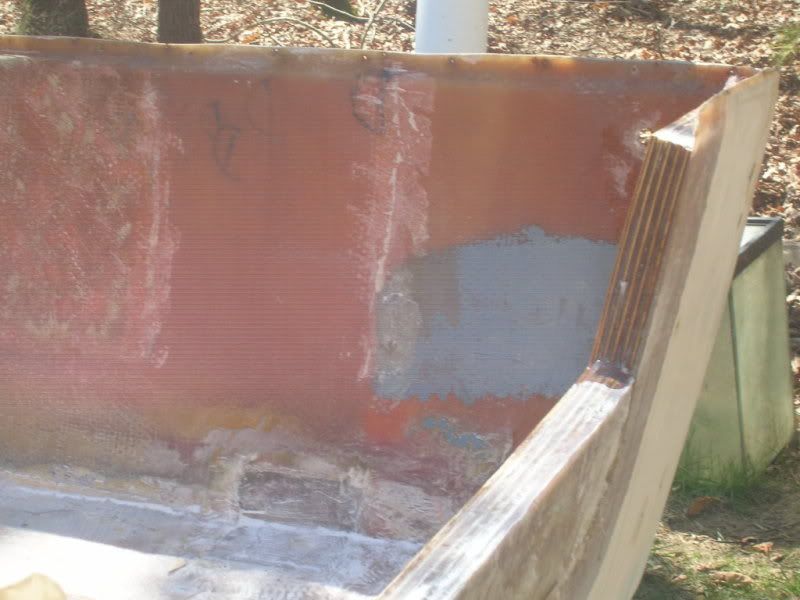

Finally, after waiting for three months, it was warm enough to do the transome on my 1978 MA. See attached pictures.http://i596.photobucket.com/albums/t...gteeth/007.jpg
http://i596.photobucket.com/albums/t...gteeth/008.jpg

Been busy watching Glen Beck reruns on youtube. What happened to the interior shots? I want to see the art dude! It looks like marine ply was used huh?
Old 04-06-2009, 05:00 PM
Finster Finster is offline
Join Date: Nov 2002
Posts: 1,855
Default Re: Transom is done baby!
No marine grade, 5 layers of regular 1/4" ply with bi-ax and mat in between each layer.
I don't know why he didn't post any interior pic's?

Epoxy?
Old 04-06-2009, 05:48 PM
Join Date: Nov 2002
Posts: 1,855
poly
http://lecharters.com
'76 23 SC CC I/O
'86 20 Aquasport 200
There's more but w/e
Old 04-06-2009, 05:55 PM
hermco hermco is offline
Join Date: Mar 2002
Location: Jensen Beach, FL
Posts: 827
Non marine grade 1/4" plywood without epoxy?
