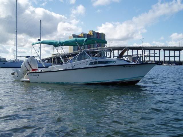

Is there a track on top or side of the coaming? I mounted my sun top (Rear top) on a track so I could slide it aft, where it lays down on transom, or partially forward when bimini top is up (I tie it to rear bow of bimini in that case), or all the way forward to lay on top of windshield, where I used to stow it when trailering. Mine isn't the OEM top, but I think they may have mounted similarly for same reason.
Here's a shot of mine from 1975 with the original Navy top and an aft bimini or sun top I had made up. Don't think I had the slide on it at the time.
Here's a shot of current top.
[/image]
Here's a close up showing track/slide on rear top mount. [image]

I don't have the slides like your picture. There is nothing at all that I can see where this thing would go, hence the confusion. Just the fishing rod holders.. But no brackets. I am quite sure my grandfather never used the aft bimini, as we found it in his shed rolled up. My dad said the boat came with a full zippered camp type top. This is pictured in the original photo, but we found no signs of the curtains as we searched the shed and attic. Anyway, I'm thinking there may not be hardware for the top on the boat, I can send a picture of the top and fittings that are on the boat if that helps. By the way your boat is AMAZING! Very inspirational!

Thanks Brenda. The 72 brochure has some shots of the full "Camper Canvas" as it was called, so that might give you some idea of how it was mounted. You might want to install the slides like I did, as that will give you a lot of flexibility for where to put the aft top when you want to fold it down. The slides can be put on the top, inside or outside of the coaming, depending on the width of the bows in the top.
