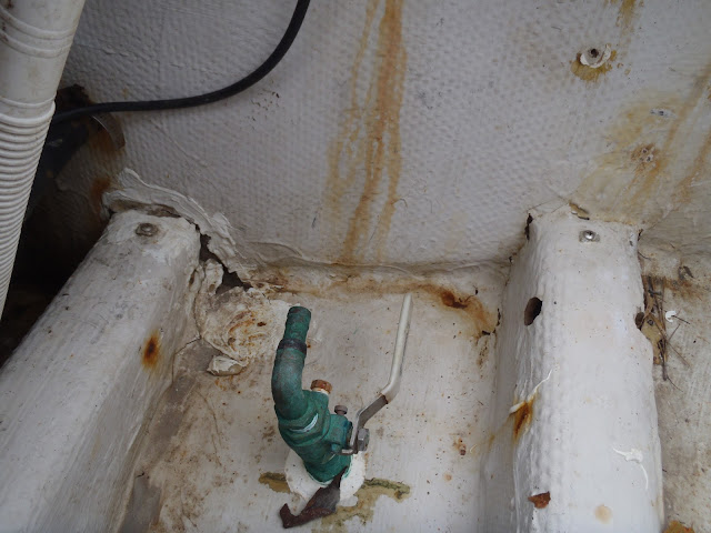

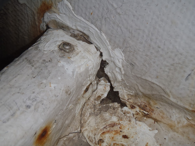

My first issue is that the two stringers on the port side of the boat have cracked at the joint with the transom. I had posted this once before and the advice I received was that I need to do some grinding and lay down some glass matte from the stringer to transom (I know its more complicated, but its the basic idea). The other problem is I can't tell if this is happening on the other side due to that silly live well box...would like to remove it though as its pretty much worthless to me.

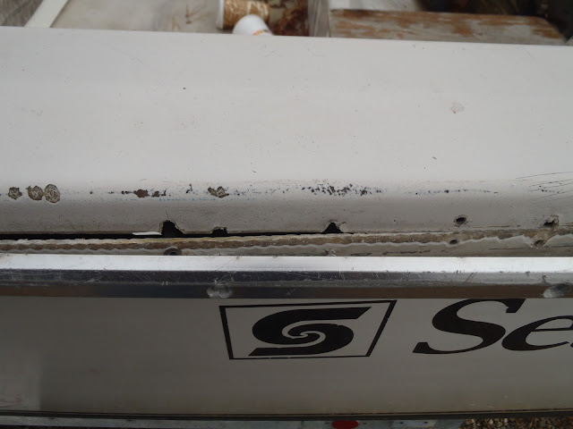

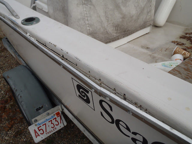

My third issue is that the metal rubrail is pulling away from the hull, again on the port side of the boat. There is about a 3-4 foot section which has completely popped off on on the front of the boat. In the rear about a 2 foot section has popped off. The holes are completely stripped and would be required to be filled and redrilled.
My last issue, related to the above, is that the rivets holding the top cap/liner to the hull have popped out in the rear port side of the boat, in the same spot where the rubrail has also popped off. This section is close to 3 foot long and has me VERY concerned as I feel all these issues are related...transom/stringers seperated, inside gunnel damage, rubrail and rivets popping....all on the same side and area of the boat.

Mitch I would give a good hard look at your transom because if its not sound any work that you do will be a waist of time. When the plywood starts to rot out the torsional forces of the engine is taken up by just the glass that was never meant to carry these loads alone. The stress will show up at the weakest point in your case the rivets holding your cap/liner to the hull. It would be neat to pull a string from between your damage at the stringer and the stress point on your liner (Third picture) and see if it points close to the center of where you unzipped your gunnel. On my Seavette we found damage that pointed to close to the same area only on the starboard side In my case the top and hull were mechanically fasten by though bolting not rivets so the fiberglass took the hit.

Sorry about that I should have said imaginary sting. All the sting trick does is prove the theory of the direction of the force that did the damage and by knowing this direction allows you to find damage that isn't easily seen. In your case the damage is pretty spectacular most of it is really an easy fix even if time consuming. The gunnel you already have a decent plan for. The damage to the liner can be fixed from just the front side. You will become a contorsionist to fix the joint between the stingers and transom The transom while harder is still pretty much straight forward. With a little beer and a lot of patience or is that a lot of beer and a little patience she can be a great boat again.

Thanks for clarification Wildlandjeff, but any suggestions on how to repair the gunnel/hull where the rivets have popped out? This one has me a bit of a loss since the rivet holes are pretty blown out.
Old 11-17-2010, 07:01 PM
Join Date: Oct 2003
Location: Shalimar, Florida
Posts: 2,265
Default Re: Need help with multiple repairs to the hull.....
Epoxy and ss bolts and nylock nuts, or glass it together.

Back from the dead! So I had the transom checked out and I got the ok on it. So the next plan was reattaching the cap & hull and the stringers & transom.
The top cap/hull joint wasn't too big of a deal. I used bolts and self tapping screws where bolts wouldn't work (no inside gunnel access). I have a solid joint now. If it fails again its getting getting glassed.
Next I moved to the transom/stringer joints. This was my first time glassing so I kept it simple and got some west systems epoxy. I used some of the 404 filler to fill the gaps between the stringer and transom (after I ground out the gaps). Nat at Get The Charters was nice enough to hook me up with some 1708 cloth and I got to work. I laid 3 strips of 1708 (5", 7" 10") on top and on each side of the stringer. Then I put a final strip over the stringer to cover up the ends the on the stringer. Its look like it came out really well to my eyes! Question, should I simple paint bilgekote over this 1708 or should I put down one more layer of epoxy first?
Next up is installing the new rubrail, which I have to pickup at west marine. I used the same one that strict did in his '69 20ft rebuild, and its a pain because it comes in two 20ft long sections. Sorry I didn't take more photos I will try to get a few more as things progress.
