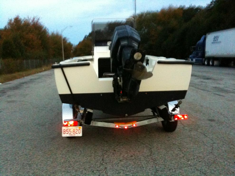

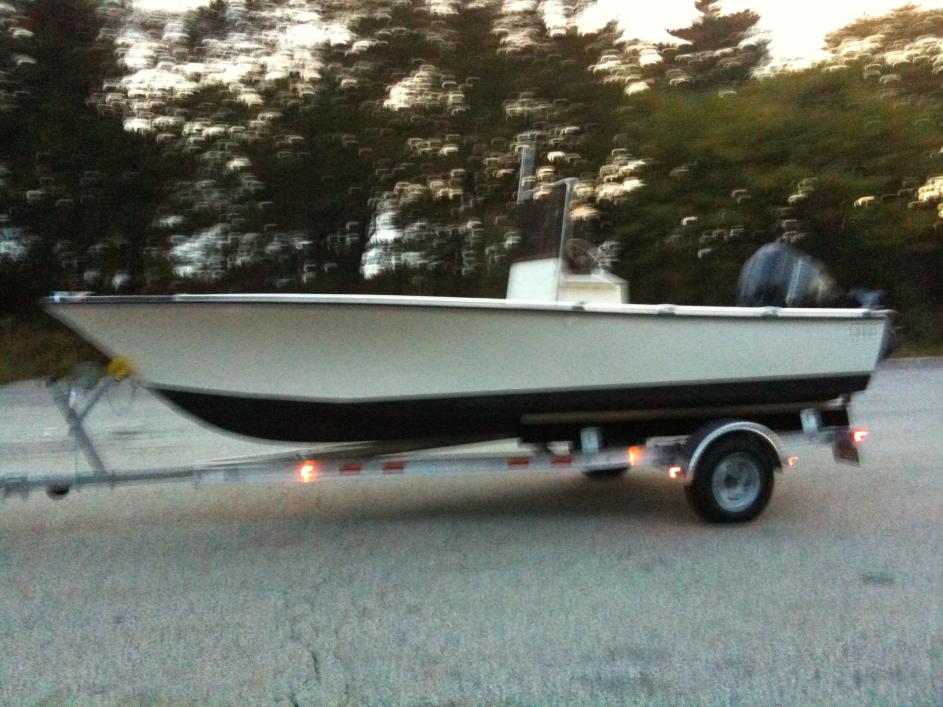

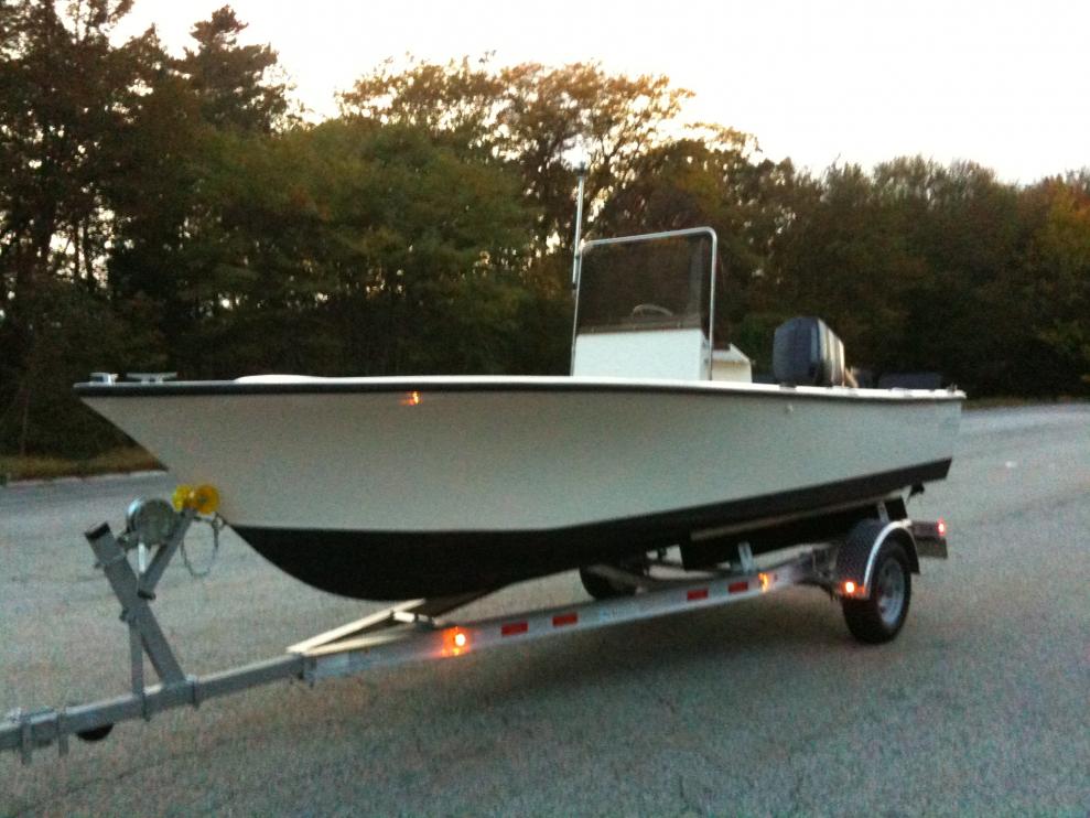

I finally found one here is my new 1974 20' SF. The transom was done with coosa composite and raised to twenty five inches. Recent awlgrip paint job, has an older black max mercury that runs pretty well for its age. 22 kts @ 4000 rpm and 32 kts @ 5000 i haven't had it WOT yet!

thats a good lookin boat. the motor on there is a good one for it also.

Congrats 'Tog!,
Classic look! Looks like a really nice transom job. What year and model is he motor? Coosa will offset some of the extra weight of the 150 (assuming its a 135 or 150).
32 knots is about 36 mph. If that motor is a 150 you can do better. Probably break 42-45 mph easy @ 5500 rpm.
Check the height of of you anti-cav plate relative to keel. 1 -1/4" is about right. Tell us about you prop, too - diameter, pitch, model. Have a blast!
If the Merc is a 115 you are dialed in...

Thanks blue and thanks McGillicuddy I will be updating performance numbers the motor is a 1988 135 HP if I can get 5500 out of it I should definitely see 40 mph +. I Will also post prop specs soon I would appreciate any feedback if anyone else has a similar setup. Thanks again!

Clean boat, that v6 should do better messing around with height and props for sure.

Hello all i took the 20 sf on its first sea trial. The conditions in Buzzards Bay was 2-3' chop with gusty winds. I got that old merc 135 to spin 5200 @ 34.5 kts. The boat performed amazing i am extremely happy with my recent purchase. I checked the anti cav plate in relation to the keel, mine is 1/2" below i may have to raise outboard one hole. Also the prop is a 14.5" diameter and 17 pitch. PS The only time i got wet was when it started to rain!
