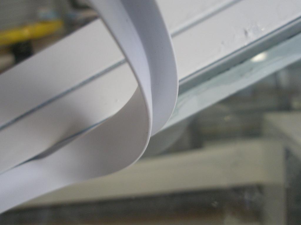

The first two pictures show what I got from American Marine to use on all my new glass.The last picture may help you see how it lays flat and actually is a bit concave up against the glass when it's pushed in all the way.(After the backside is pushed all the way in,it is locked in over the inner glass edge and the lip.)

Thanks Chuck. I was trying to up load from my server like I usually do but it would not work for me. The glass on my 25 seafari is about 1/4 inch thick and I had no problems putting in the weather stripping. Here are a couple close ups of how it snaps into place.
