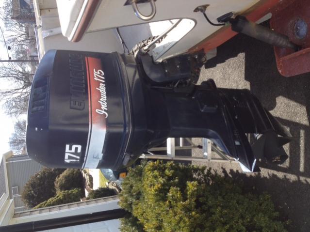

Here's the 1989 Evinrude 175 that is on the...I hate to say it...Cruisers Inc. Bonanza I'm looking at. Any suggestions? It started right up for its first start since it was winterized. It looked clean on the inside...I just need to check compression.

Looks a lot cleaner than the 140 looper

This motor certainly looks better but IMO the Seafari is a better designed and built boat. Cruisers cabin you'll find is very short, although it has good sized field to fish from in return.

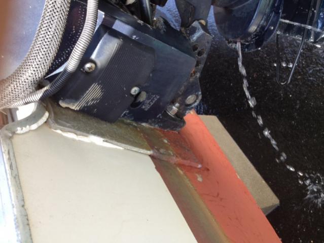

Yup...Bonanza is short on cabin, but has more deck room. I've heard a few horror stories about the transom and balsa core of the Bonanza. The thing is, I'm really looking for the best engine that hopefully has a nice boat attached to it. Here's a pic of the Bonanza transom. It passed the "engine shake" test. The owner took real nice care of it. He actually cared for it more than the Seacraft guy cared for his Seafari.

I'd respectfully suggest that your priorities are screwed up! Motors are EASY to change and good used motors of that vintage are pretty cheap! Big Shrimpin could probably find you a good fresh water motor for that boat, especially if it's a 20" transom! Good boats, however, are not so easy to find or change! I'd take a ride in that Seafari before I put any money down on that Bonanza!
BTW, a 15 x 17 prop doesn't sound right (I'm running a 4 blade 15 x 15 on my 150!) A 13 1/2" diameter would be about right, so measure the radius of one blade on it if you get a chance. Denny

Erik, the transom reinforcing plate on that Bonanza screams "I need a new transom". If you're going to sink that kind of time and money into it, do yourself a favor and get a SeaCraft. (Seafari's Rule!)

Exactly, that alum plate was put on there for a reason.... and not a good one. Walk away while you still can. Stick with a Seacraft and find a motor to fit. Or spend a little more and get a solid boat with a decent power plant.

I saw that too and forgot to mention it in my reply, so good catch Fr. Frank! I bet it was installed because of localized crushing in the motor mount area! Reinforcing plates are always a big red flag in my mind! Denny
