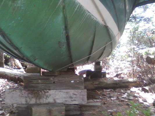

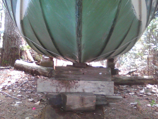

1966 Chris Craft Sportsman Seaskiff 18' fiberglass, thought i'd share these neat reverse strakes on this puppy. Bottom is 3/4" glass. she's wide / stable but not much of a deep V. Had a v-6 155 Buick w/OMC stringer drive in it and did 44MPH

That style of strake is much more effective for it's size than having a flat. Directs the water down rather than out providing more lift and a drier ride...

I never drove this boat but with a 155 v-6 buick engine and it did 44MPH, I figured these strakes helped. It's farely heavy and really wide. The hull bottom is 3/4" thick glass.

More lift = more drag, so it might be drier but it won't be as fast as a VDH for the same power and weight. Just like on airplanes, the more you deflect a fluid, the more lift you'll get, but you'll also get more drag along with it, unless you can do something clever to improve the L/D ratio. Moesly's idea with the VDH was to improve L/D by deflecting the water from the keel to the chine as gradually as possible, while also introducing a boundary layer of air to reduce drag. His testing proved that it worked, producing a hull that was about 10% faster for the same power and weight as a conventional constant deadrise hull with flat strakes!

This boat doesn't have much of a V at all. It's pretty flat with like a 6" skeg. Thought these strakes were kinda different you dont see often. Not sure why you guys cant see the pics. I attached them the only way i knew how.
