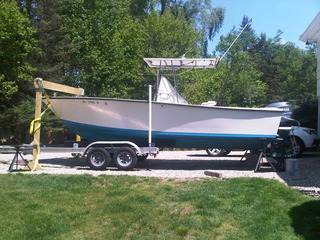

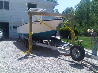

I found some boat jacks on CL a couple of years ago and like to paint the bottom without reaching around and crawling under the trailer. I followed the directions you see on this site, lower the front of the boat, block the back, lift the front etc. It was a tedious process jacking up the bow and shifting the trailer forward a couple feet and then re-jacking to get the trailer out from under the boat. I set up the cross bar in the picture so I can slide the trailer out in one move. I use a come along to pull the trailer out slowly. To pull the trailer back in I use the winch on the trailer.

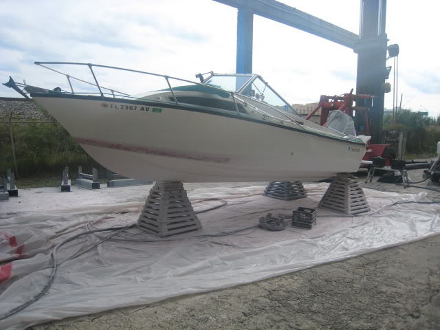

Don't need a crane, just a little ingenuity! Your best bet for supporting hull is to try to find/borrow/rent some boat stands or big jackstands. I was able to borrow some from Don Herman. Next best would be 8x8 timbers. You can also built up a pyramid support using 2x4's pretty cheap. Check out photo below of these that the boatyard used where I had my boat soda blasted.
Be VERY careful with concrete blocks . . . they're very weak especially if not oriented correctly (with webs facing up)!
