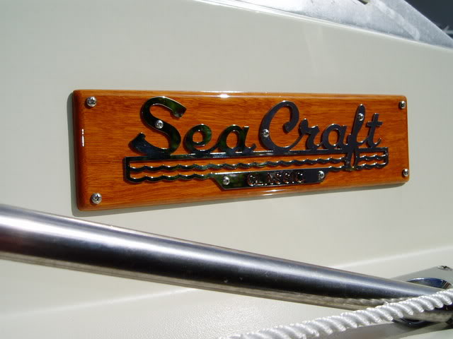

Don't know where you live, but in S. Fl. the teak oil treatments will start to oxidize and turn dark after a couple of months; they get really dark after about 6 months. I've had my boat since 1975 and tried just about all the teak treatments including Deks Olje and Honey Teak. High gloss varnish seems to hold up better and looks better IMHO. The longest lasting I've found is Epifanes Wood Finish Gloss, about 6-7 coats. PowerBoat Reports magazine tested a number of teak treatments several years ago and rated it best, saying it held up better than Honey Teak, which was their previous top pick. I used it on this piece of mahogany trim about 2008, and it still looks good.

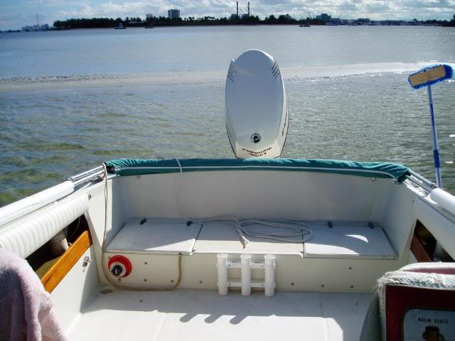

The teak boards lining the cockpit shelf were also done with it in 2007 and have also held up well. I do keep the boat covered when not using it, which keeps the UV off the varnish, so I'm sure that helps a lot. That doesn't help with the teak oil treatments however, as oiled teak will turn dark even if covered.
I used Honey Teak on the cabin door in 2007 and it doesn't seem to hold up as well as Epifanes and it also is a darker finish that I don't like as well. There are some spots on the door frame that now need redoing.
