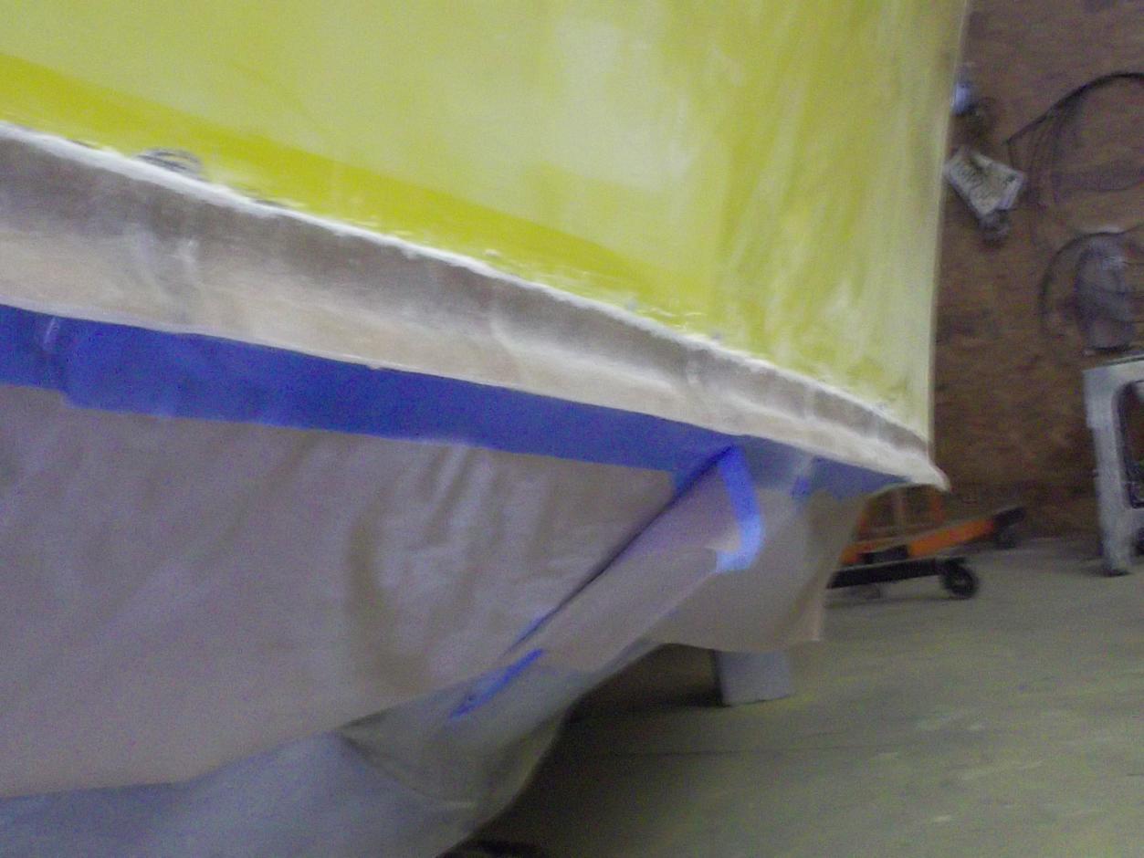

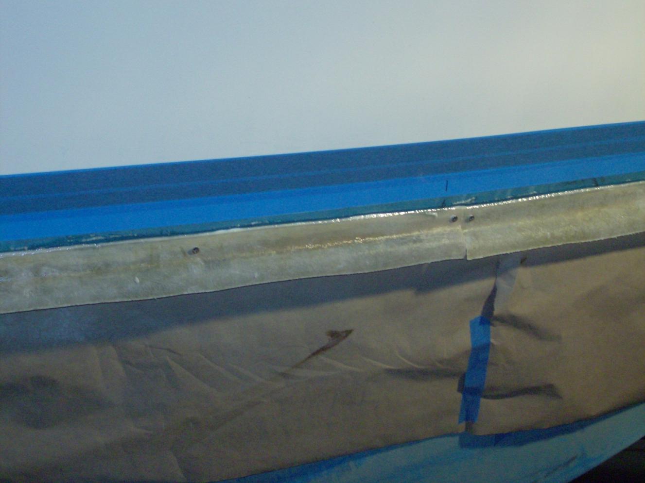

these are rails i've set up other boats with:
these were installed on a 24 blackfin,a noted wet boat - these,according to the owner of the boat,have cut down the amount of spray by at least 80%...
these are made of fiberglass,and laminated to the hull,then glassed over,making them integral with the hull - unbreakable...

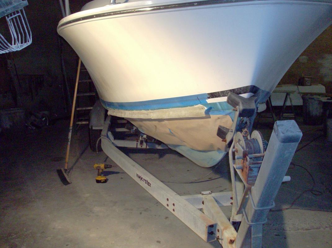

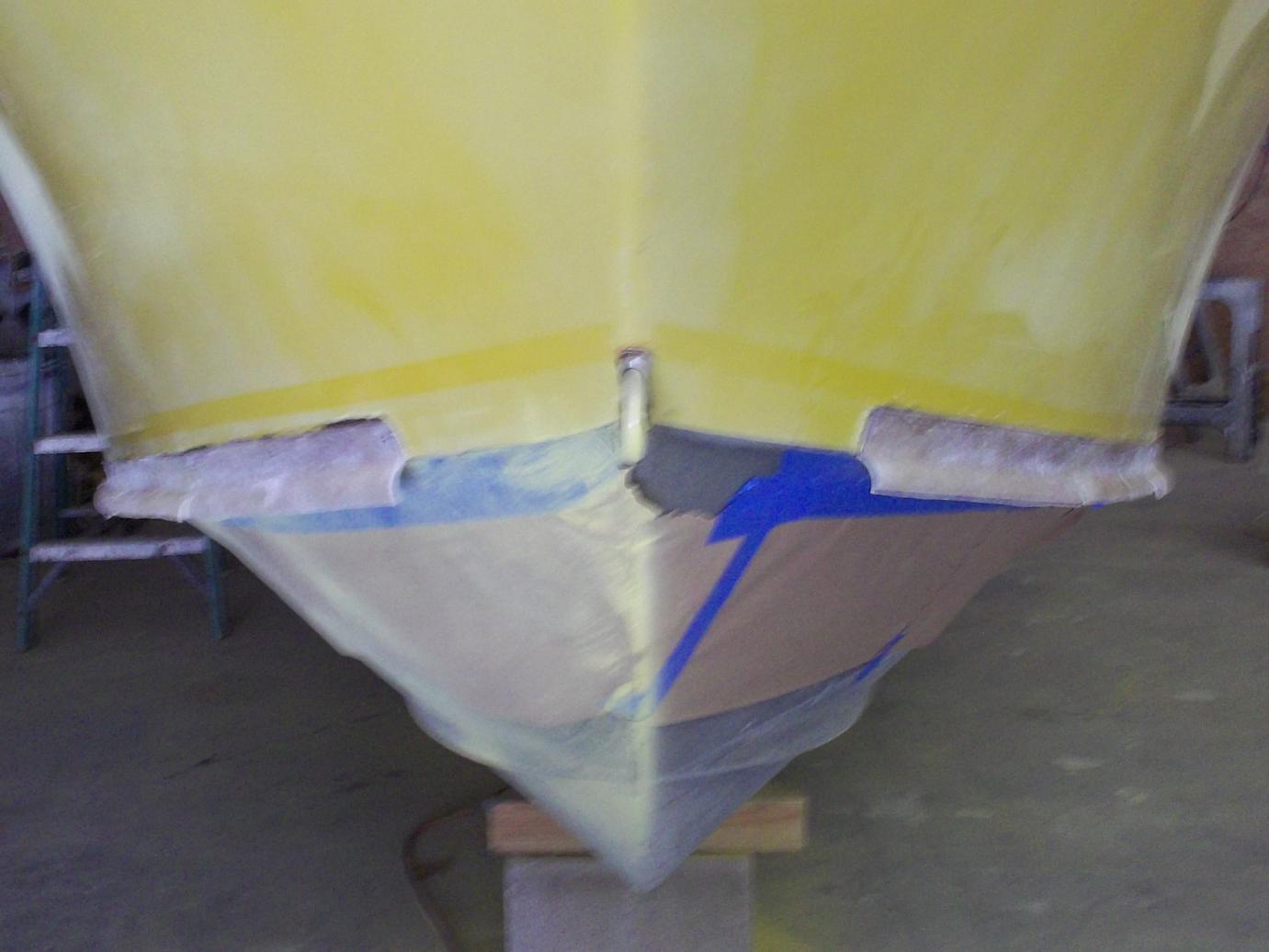

these are the same rails,installed on my own sea craft
props may help bow and hull lift,but the rails will improve the overall "dry factor" of the boat...
