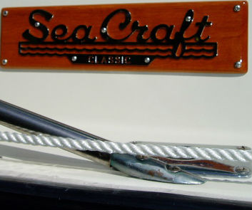

What about a bow rail holder where it starts going fore.

Sandy's idea to use bow rail end fittings with SS tubing like the one in picture below is also a good one if you want something more robust. Don't know if they make those fittings with different angles, but you might be able to sand/grind the bottom of them to change the angle. Denny
