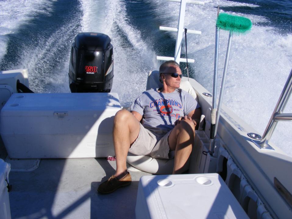

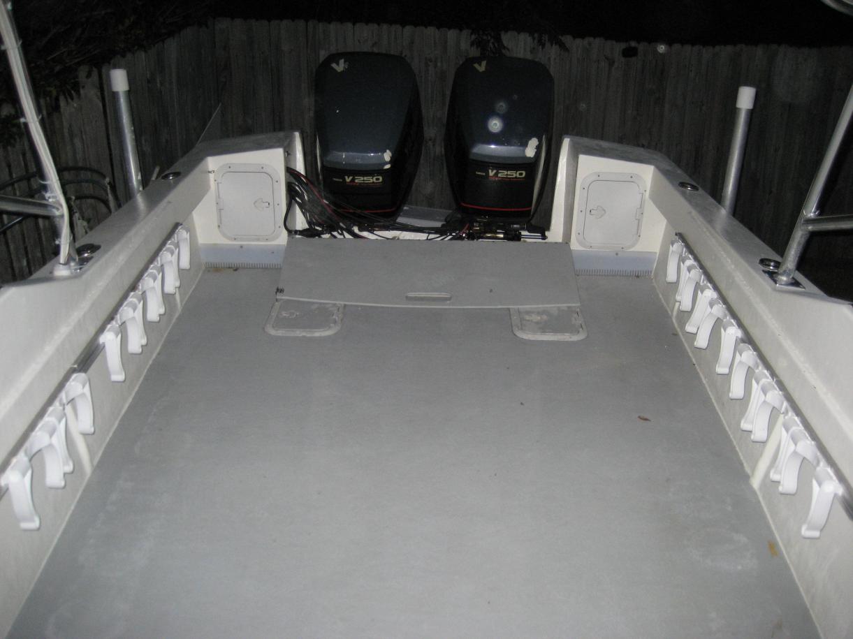

Went from twin 250 yamis to single 250 Zuke and will never look back. The boat performs 200% better with a single.

Well, you can't run faster than with the single zuke out of the channel so other than short bursts of haul ass and terrifying chine walk at 50 knots.... I guess it ran ok. I actually bought the boat from a friend who had the twins on it for redundency......... and cause it looked cool too.
