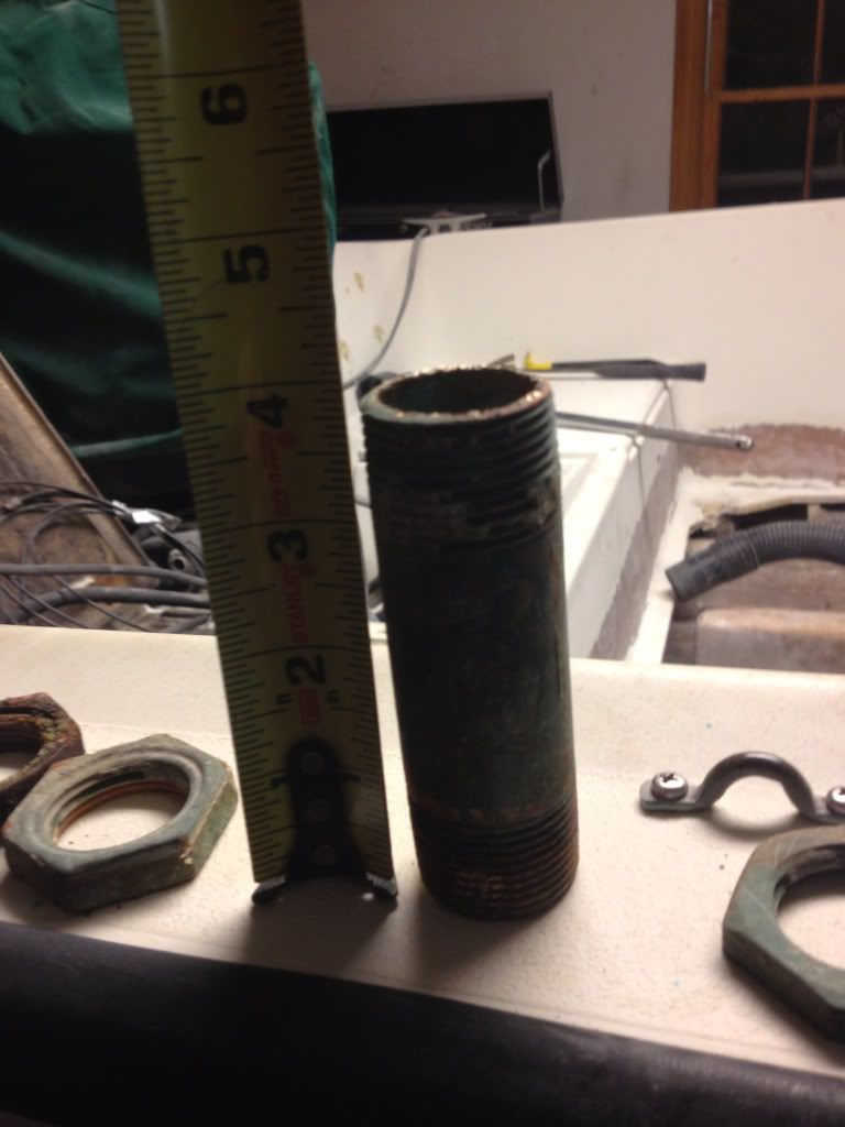

Finally got the big nuts off the bottom. Inside the boat there is another big nut with epoxy right up to the top of the nut in the recessed area. I got most of it out but how the hell do I get them out of the boat? Just beat the hell out of them from the outside? The nut is 1 3/4 inch. I'm gonna see if someone at work has a big azz socket and breaker bar.
You can kinda see what I mean in this older picture. With all the epoxy right upto the lip of the nut

At first I thought those were bronze thru-hulls, but after reviewing pics again I see nuts on both ends, so they must be brass or bronze pipes. They will be much thicker than the thin OEM brass tubes that Strick shows in his reply, so what works on those thin tubes won't work on thicker pipe. If bedded in epoxy, they will be tough to get out, although heat will soften the epoxy and will probably help, provided you don't start a fire! Some sort of puller, based on threaded rod, nuts, washers, a larger-than-pipe socket on one end, and a tapered socket on the other end with the same OD as the pipe would probably work best.
I assume you think the scuppers are leaking if you're considering all this work, but if there is no obvious leak and they're bedded in epoxy, I'd be inclined to leave 'em alone! Grinding the end of the tubes flush with the nut on the bottom would improve the suction behind those wedges, however. The fishbox up front on the SF models also has a thin brass drain tube that's prone to leaking, so I'd check that to make sure it's not a leak source before attacking the scuppers! Denny

Alright, it took a 1 7/8 inch socket and breaker bar and a hammer to get em out but they are out. Obviously they are not original but these suckers would probably never leak with how thick they are. The hull bottom is 3/8 inch thick.
