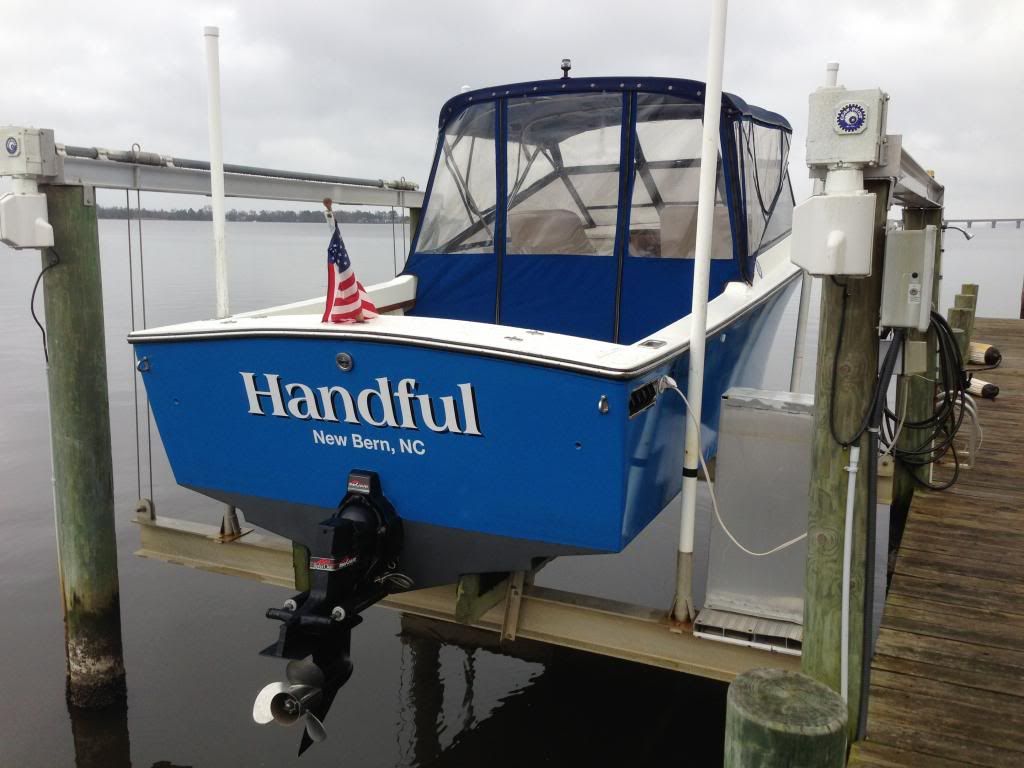

No guru but I'll offer a couple of simpleton observations:
Its probably there, but I don't see a zinc trim tab under the blue one's anti-cav plate. I am amazed by the impact the little rudders have on steering and managing steering torque.
A 4 blade prop would likely help also low speed maneuvering.

Have you played with the trim at all? My I/O wanders a lot more when it is trimmed up/ out.
Also not sure if it's related or not and it could just be the angle of the pic but your drive looks to be mounted really deep.

Boy, do I feel dumb. I didn't notice the missing trim tab. Surely that would make a difference way out on the outdrive in the prop wash. I've also been having problems with the power steering pump, which is being replaced, and my mechanic just told me the actuator will have play if there is not enough pressure from the pump. I'll try these things first. Thanks for the comments.

First of all, the Sceptre/Tsunami single stern-drive models DO have the worst steering wander of any boat I've ever driven but one in 45 years of boat operation. (The 23' Martini small-block single Alpha I/O is worse)
Second, the absence of the torque tab will have a slight effect, but only slight.
Drive angle makes a difference, too. At displacement speeds, the deeper the drive, the better.
If you have power steering, check your actuator for play and your pump for fluid.
If manual steering, check the steering head.
4-blade props wander slightly less than 3-blades. (I don't know why)
While on plane, how much wheel turn do you have before the hull responds to the helm?
I used to have a 23' Tsunami w/ 225 Johnson, and it wandered so badly I would not leave the helm while under way.

If you have power assist steering on your boat then Mercury does not put a zinc torque tab on the out drive. Manual steering yes.
