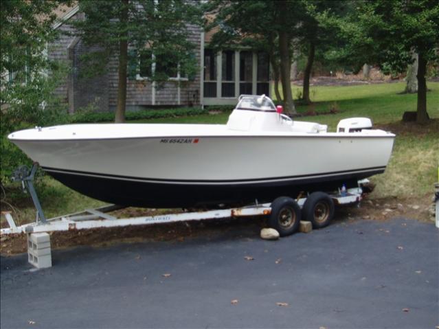

I had a '72 CC that was converted to a transom-mounted OB (had a '89 225 Johnson). The console wasn't original but it was a factory CC configuration. The hull bottom and deck are cored, hull sides are all glass. I had mine when my father had his 23' Sceptre and I was more impressed with the Seabird's ride than the SC. Now some of it may be the difference of a CC vs. cabin layout - driving position, center of gravity, etc., but if I dropped the tabs a bit into an honest 2-3' chop, she would eat it up.
To compare, I bought mine with a ratty painted steel trailer and no electronics in late '03 for $3700. I sold it in '08 with a brand new aluminum bunk trailer and electronics (VHF, FF, chart plotter) for $5,500 after having it on the market for a year.
Pictured here with aforementioned ratty trailer.

Posts: 1,056
I did not know the hull sides were not cored. Maybe that is why I never had any core problems in the sides.
Are you sure about that? Drill a hole through the side?

Now I remember where I saw that boat, thanks Scott.Nice to know that at least the sides arent cored.
Yup. When I bought the boat, the previous owner had mounted 0 degree swivel rod holders in the gunwales and reinforced them by anchoring them to the hull sides. When I removed the rod holders, I was able to confirm the sides were solid glass. If you look in my photo, just below the rub rail 3-4 feet from the stern are 2 bolt heads about 12-14 inches apart. That is where the rod holders were anchored. I believe the coring ended around the chine/waterline area.
