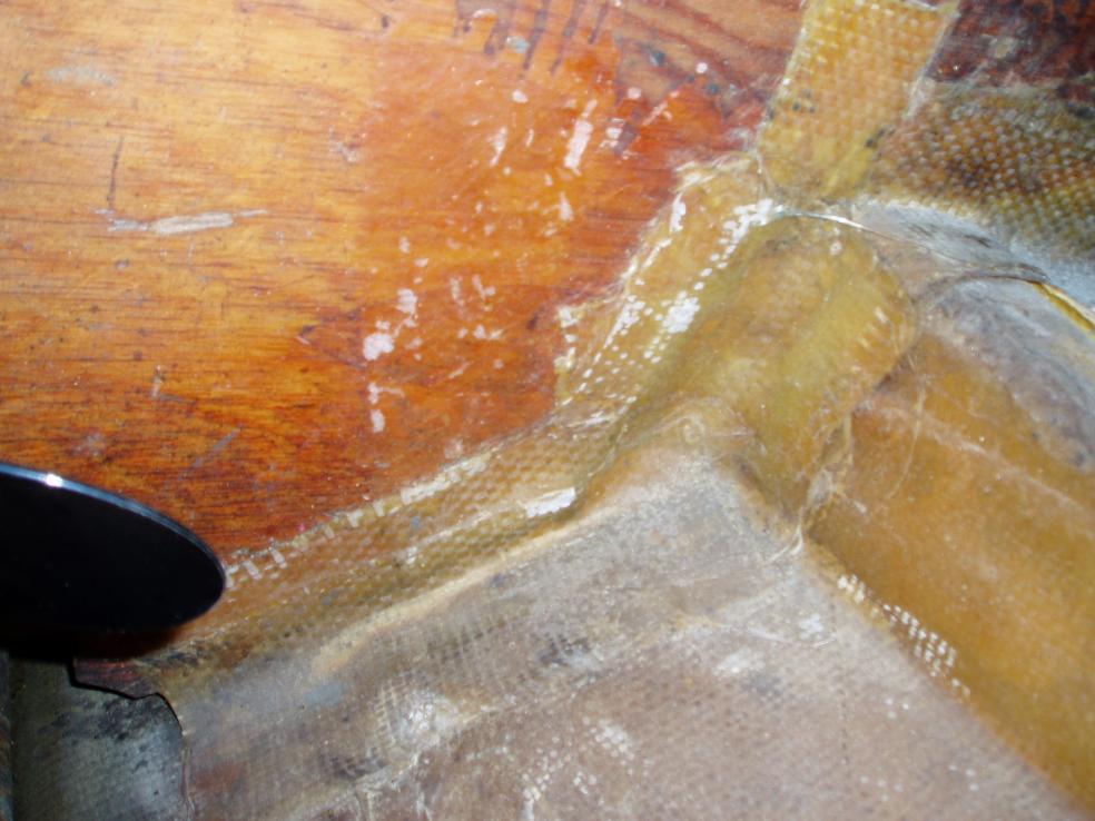

I've attached some pics of the port bulkhead and some shots of the bulkhead just forward of the head which runs between the 2 inner stringers, looking aft thru the front hatch under the bunks. Don't know how big the box is under your front hatch, but you might want to consider just removing it because you can access a lot more volume in the hull without the box in the way, although it's potentially wet storage if you get much water in the bilge! I keep a spare prop up there, attached to a stud I installed in the bulkhead!

I have the gel coated boxes under the bunks on both port and stbd side. Only the forward hatch opens to the bilge. Don't know if you noticed that glove box on the port side of bulkhead, but it provides a neat shelf inside the cabin, but it's so far over to the side that it's not really in the way. Glue some 1/4 round on the top of it and it makes a handy storage area. See pic below.
