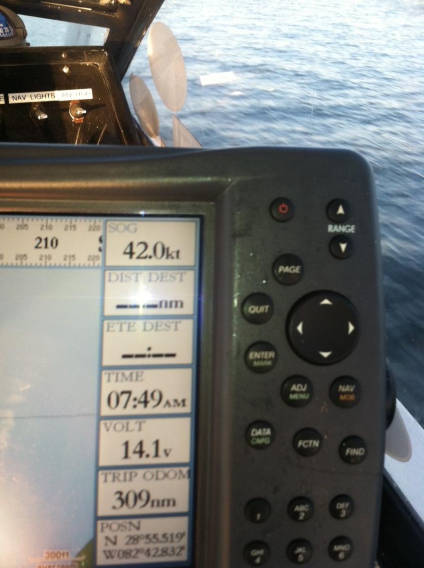

I am a Suzuki owner of an often heavily loaded 23 Tsunami. I have the 250 but the engine like many others is the exact same from 200-250hp other than de-tuning to meet hull manufacture hp limits. Considering my sled with tower is considerably heaver than the CC and tops out at 42 knots, you will be fine with the 200. At worst you may lose a little speed at WOT as I am pretty sure part of the "de-tuning" is done by lowering the rpm of the rev limiter. In either case I wouldn't beat you to the channel marker if you were propped right with the 200.

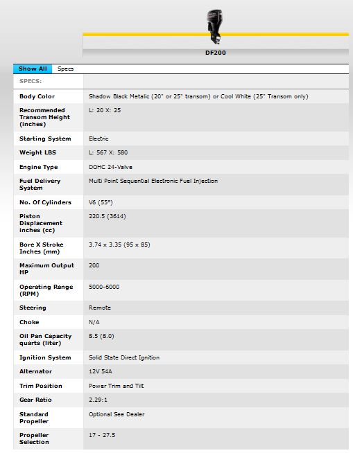

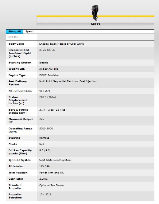

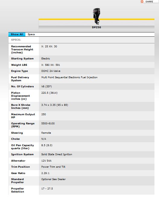

As far as re-tuning.... Well, I just confirmed that the df 200 - 250 series all share the exact same displacement so there is no physical difference enginewise. That leaves it to just two items: Fuel/air delivery and or ECM. I'd be willing to bet all differences exist in the ECM to which that would be all I think you need to find. Attached are the spec sheets for all showing only RPM redline changes.
