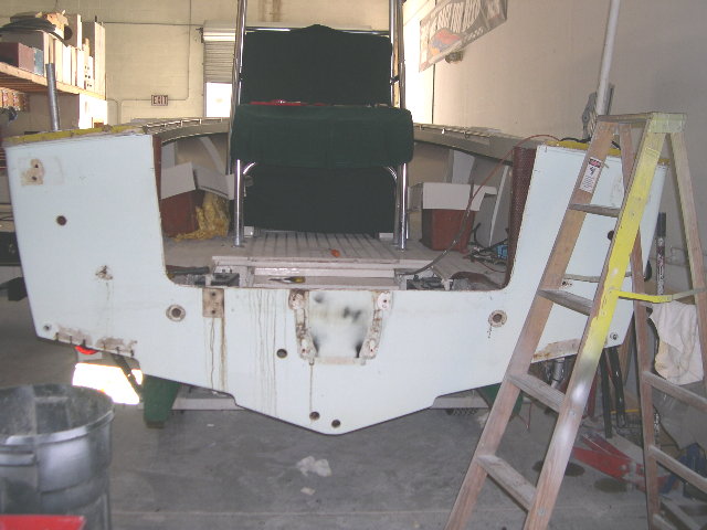

All good advice here!. Here's a wet Transom (notice drips from trim tab backing plate screws
