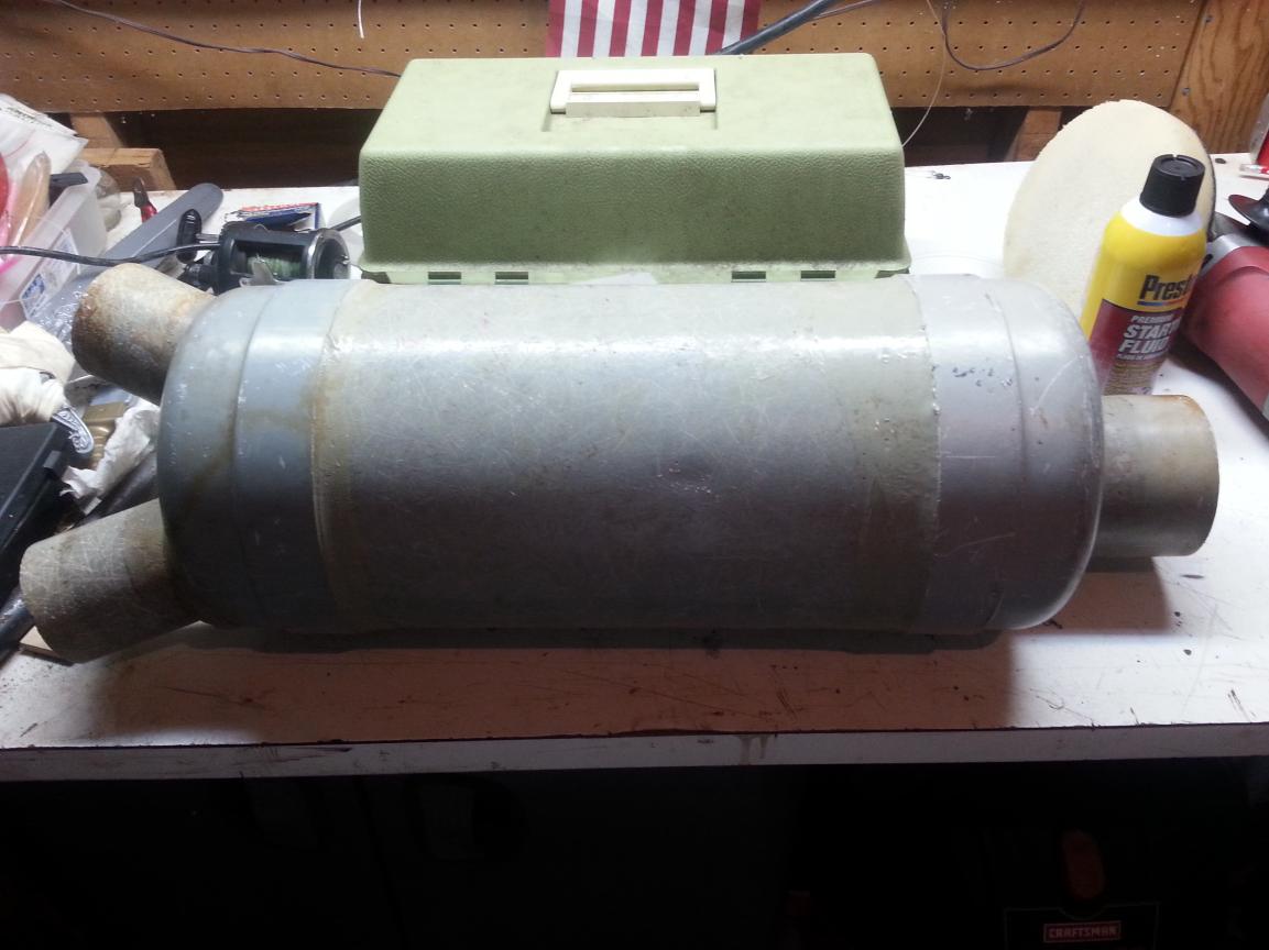

After a some long fishing trips where I spent the day trolling I realized that the v-8 growl out the straight exhaust on the inboard was too overwhelming. I started looking for a muffler and low and behold the right one popped up on Ebay and it is now mine!
The muffler has dual 3" inlets and a 4" outlet which is offset. My question is which way is the proper orientation to install it? I can see the baffles inside
the muffler and my guess is that the outlet needs to be mounted on top so that the gases pass through the trapped water. Anyone know if this is correct?

I have the same issue on a 23 inboard restoration project. The boat was a basket case when purchased but the muffler that came with it looks like what you have in the picture. Being below the floor I would assume that it is full of water until on plain when it would continually drain itself. I would imagine that the original configuration had this some type of mounting or attaching to the hull to eliminate vibration. Anybody have any pictures of an original setup or knowledge of how they work? Mine has two 4" inlets and one 4" outlet.

Deep, took a closer look at mine today and it was rigged with the inlets and outlets closer to the top. It looks like you are right the baffles divert the gases into water to kill the noise. Hope this helps what kind of power do you have? speeds, fuel consumption ect.

Outrageous -- After reading your post about your muffler I took a closer look at mine. The inlet's definitely have a slight upward slope to them which I had not noticed upon initial inspection. This would place the exhaust outlet on top. I really appreciate your input. Now the question is if I will get lucky and have the space to slide the muffler in place without having to pull the rear deck.

I don't know to much about The inboard setups when it comes to mufflers as I have always been a sport boat nut with through hull exhaust. The more I look at this setup the more questions I have. A mock up of mine has the muffler lower on the engine side than it is at the aft end. (Seems it should be lower on the rear) It is also not centered very well (a few inches favoring port) What happens in the winter when below freezing? There isn't a drain on this thing, maybe I should add one. As far as being able to get it in without pulling the floor up I would think you would have to be real lucky. I have fuel tanks out as I an replacing them along with the floor and its still a pain to see whats going on as far as support under the muff. You maybe better off to start after the fishing season ends. I have a 350 going in that will be about 315 or 320HP. Hope to be pretty fuel efficient.
