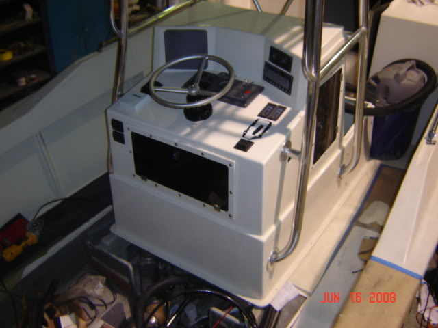

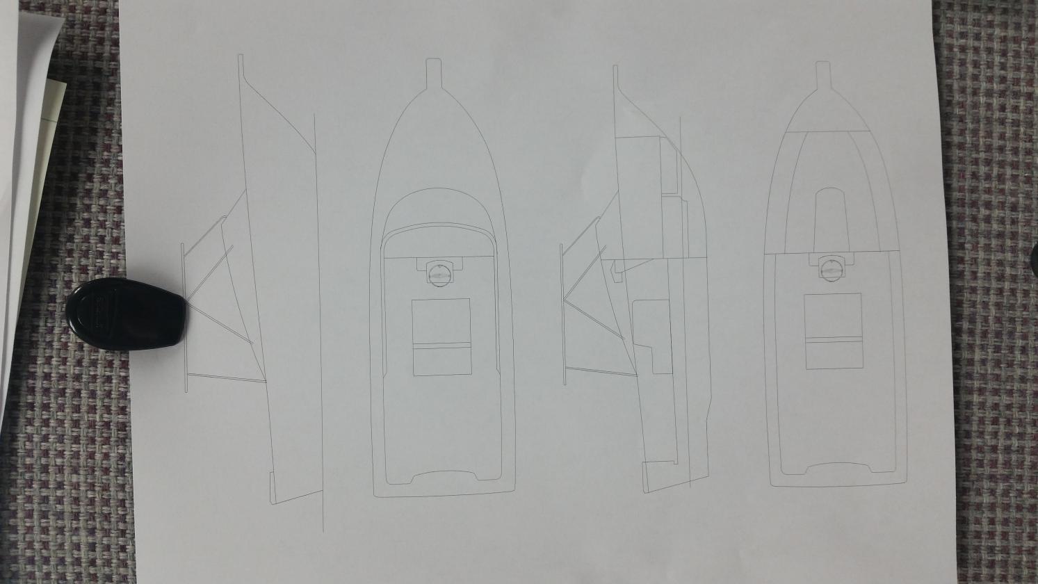

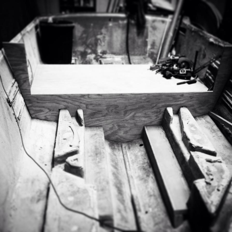

First boat pics are from 08 when we did the transom. Outline drawing is the overall look we are going for. Recent work includes 2nd engine bed stringer, deck joists, and a few bulkheads.

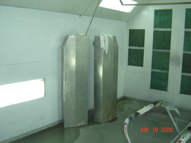

Forgot to mention...new saddle tanks. Power is new 4lha Yanmar with new ZF63. Looking to get ZF63A if anyone has one. I already made a custom dry riser before this new rendition, I'm hoping it will work for this layout. If not, I will make a few cuts and re weld. The hard part (water mixer and machined v-band flange) will work no matter what.

I like your "express" design.
