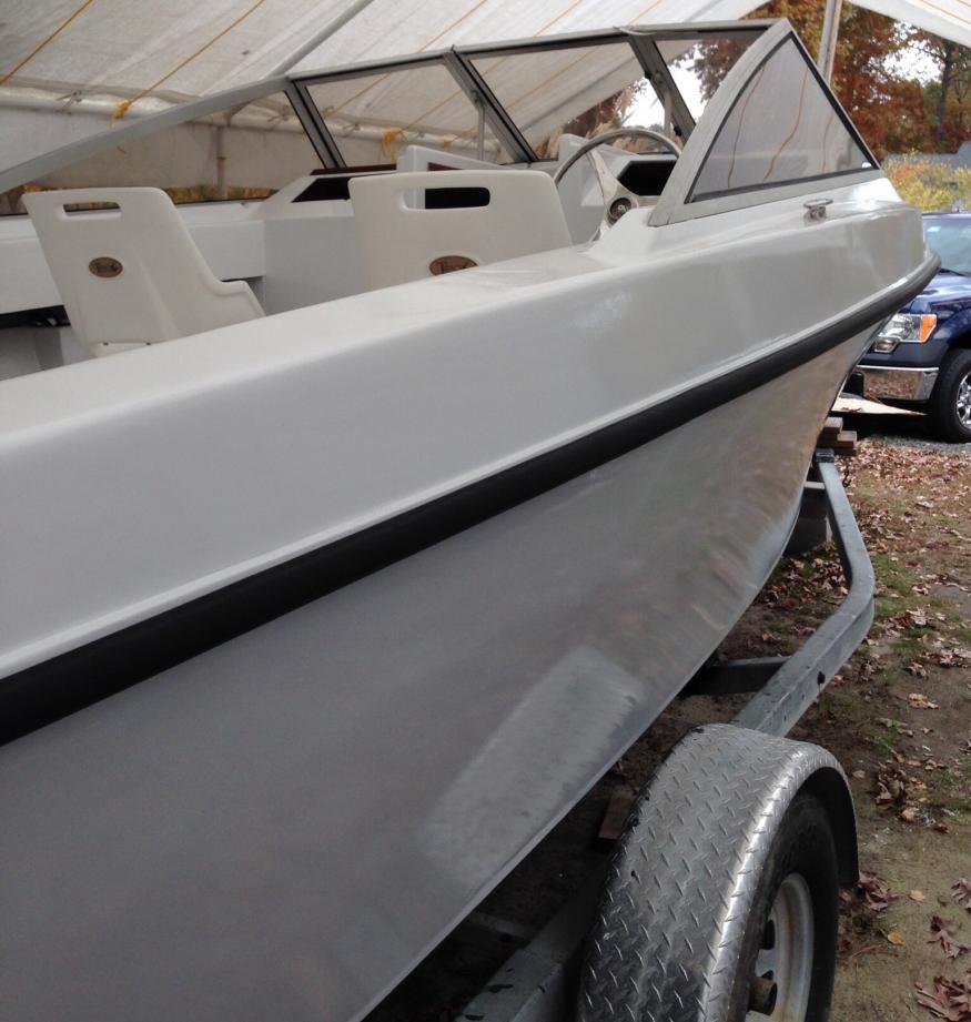

Recently painted my boat with Signature. Tom knows his stuff. I was very satisfied with the results. He includes everything you will need to do the job.
Highly recommend.
Here's a pic after roll on paint job.
