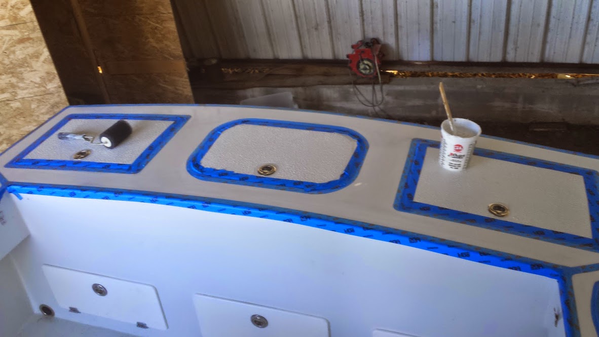

Helped a customer put some Kiwigrip down on the boat he built. Came out super sharp The guy built it, all, himself, one man ..... he is not even a boat builder by trade.

I've used the Kiwigrip and found if you do it inside out of the sun and use two people, one to apply and one to roll it works much better. Can't let it sit too long or do it in the hot sun. Take the tape off quickly and you will get great results like you did!!

Good question Terry. When I used it they only provided one size of roller, which seemed like it made it a bit too rough. I would like a smaller "weave" in the roller to make it not so rough. The good thing is you can take some 220 grit sandpaper and knock down the sharp tops after it hardens.

I agree, that is some pretty rough non-skid. You will never slip, but I dread the fall and the associated road rash if you did. I'd opt for a slightly less aggressive texture.

I used kiwigrip on my 18SF when I redid her a few years ago.
Full deck, and top cap on an 18 used half a gallon, one coat. Maybe slightly less.
I bought white and had it tinted to a custom beige at my local hardware store.
You can have it tinted to whatever color you like.
My texture came out pretty smooth actually, I would not call it "too agressive" at all. It all depends on how you use the roller. Dont keep rolling it while its tacking up. Thats how you get the tall stiff peaks.
exactly! Yours came out very nice BTW
You can change the texture by adding more/less material. The more you put down, the mor agressice teh roller cover will make it. Also, you can go back over it with "cigar" style roller to reduce the texture as well. Its important to have the same amount of material everywhere, thats why the notched spreader is so important
