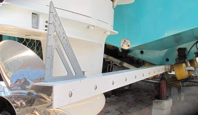

Here's a summary of the measurements I made using the setup pictured below, where I carefully trimmed motor to make sure AV plate was parallel to keel. Last set of numbers in each row is what height would be on a 20" motor:

OK, here's the code to interpret cryptic table above. (Sorry the "columns" don't line up but didn't have time to make separate table!):
OEM = motor mounting bolt holes located where Don Herman originally drilled them. He later redrilled the holes at a 1" higher location, which is indicated by OEM + 1".
Mounting Hole #: Top hole in motor bracket is #1, bottom hole is #4. Distance between holes is ~11/16"; total distance from top to bottom hole is 2".
I don't have any good photos of my AV plate at cruise . . . need to put some black tape on it because it's hard to distinguish the white motor from white water, but it looks like AV plate still needs to come up another 1-1.5" so that would put it at 4.5-5". Don and I have discussed bracket mods required to do that but it won't happen for at least another couple months.
With regard to a 20" motor . . . my measurements indicate that if it was mounted as low as possible on my boat, the AV plate would be 5.5" above keel and I think that MIGHT be 0.5 -1.0" too high, depending on what prop you run. Will know better after I raise mine and test it. I need a stern lifting 4B prop; the PowerTech ELE4, the BRP Cyclone and Michigan Apollo 4B props all seem to grip pretty well and may be able to run higher. Dixon said he could run a 3B Stilletto prop very high on his transom mounted motor, but it might not generate the stern lift you'll generally need to counteract the CG shift created by a bracket on a 20.
All of the above numbers are for a 25" E-TEC on a Hermco bracket with a 30" setback. I don't know if all brands of motors use common standard dimensions but it would be worth measuring hole spacing to be sure. Don mounted the bracket per his recommendations; swim platform height is about 2" above water at rest and just touches the water when a couple of big guys standing on it, so bracket height is perfect and I wouldn't want to change it.
Now I have to admit that I didn't see much of a performance increase with the last 1" raise of the motor . . . maybe 50 rpm and 1 mph . . . so maybe it's not all that critical at the 20-25 kts I typically cruise at, but all the experts on both the E-TEC and Verado forums say that the AV plate is designed to run on top of solid water, so you've got extra drag if it's deeper than that. Plus all the years I spent trying to tweak jet engines to get the last 0.1% improvement in thrust and/or fuel consumption has made me a fanatic at trying to get the most out of an engine, so it kinda bugs me to know there is a potential improvement I'm missing!
