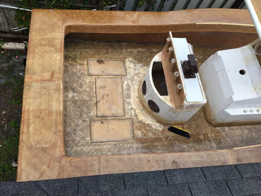

Need to finish tabbing under side of gunwales and floors to stringers u know the fun upside down stuff trying to decide to pull trigger on colors thinkin sea foam or Aqua mist with cream nonskid areas

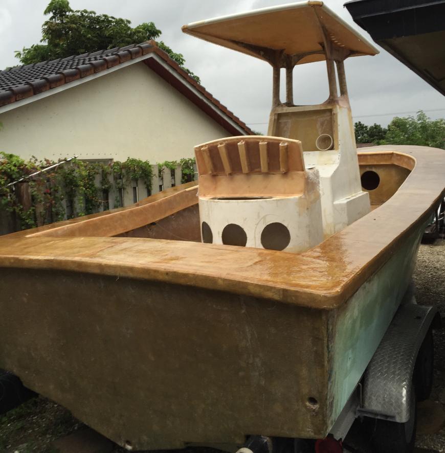

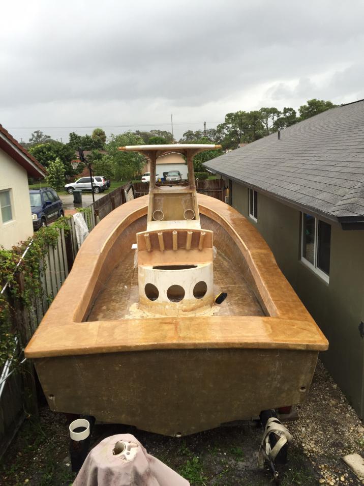

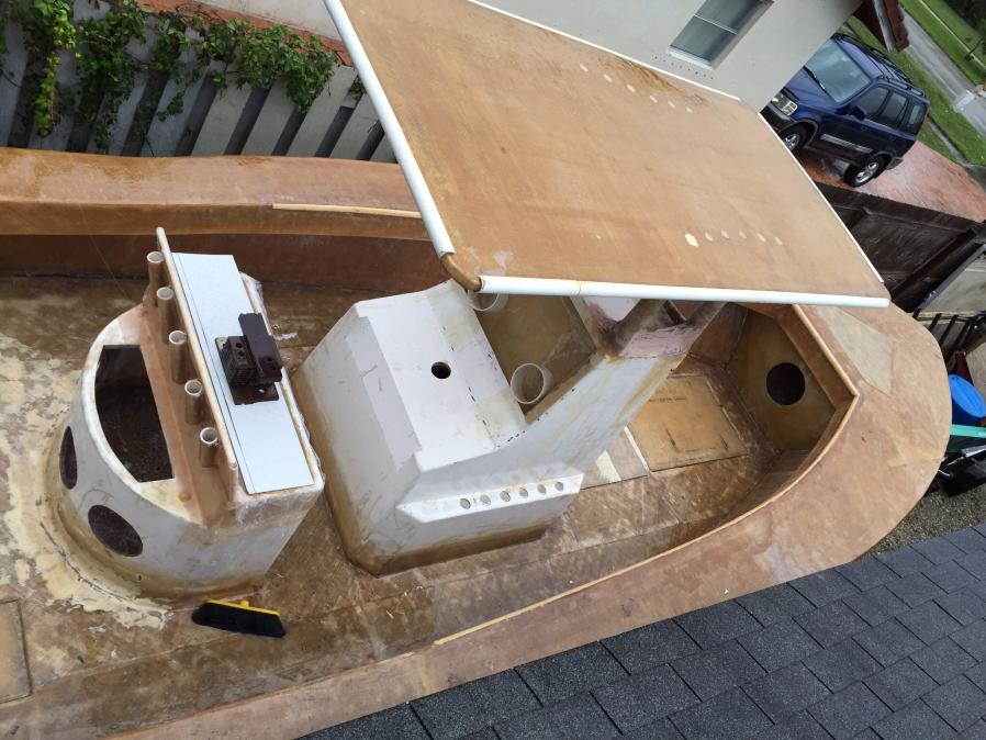

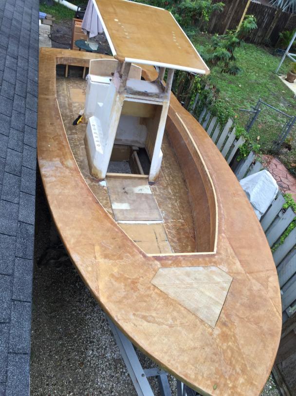

More glass then u can ever imagine. For one person to attempt in a year of free time

Yes your obligated to get them one at a time because iPhones apparently have Hubble telescope capacities😳. I'm curious why we love to hate this itchy hobby so much for a badass boat.

nice job, how do you plan on treating under the transom cap to cockpit transition? solid with scupper tubes through? looks like some storage space is available

The floors have channels on the sides of the crowned deck that lead through transom into scuppers no tubes just thickness of transom which is 2 1" blue water 26 panels in multi layers and tabbing. the floors were raised crowned and all one level from where the old floor was as far as transom transition to cockpit not really sure if it will just have a single rig tube and then finish it like it is or cover it up. But everything is planned to run through bracket like hermco rig theirs instead of through transom. Under the floors is a Shiite load of storage as the stringers where redesigned with 2" nidacore
