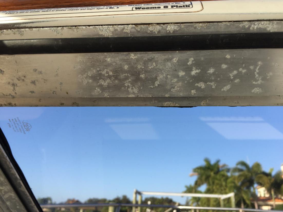

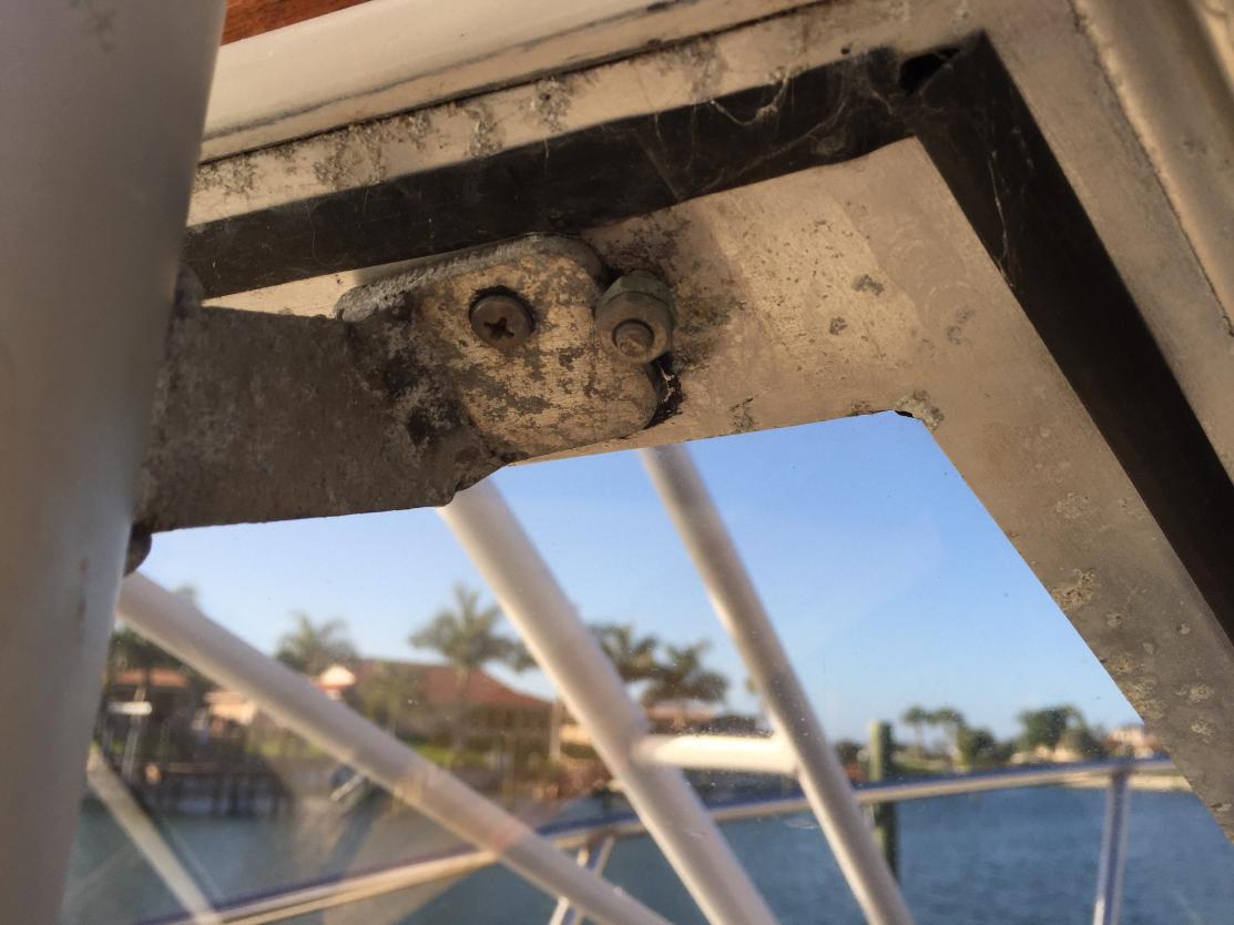

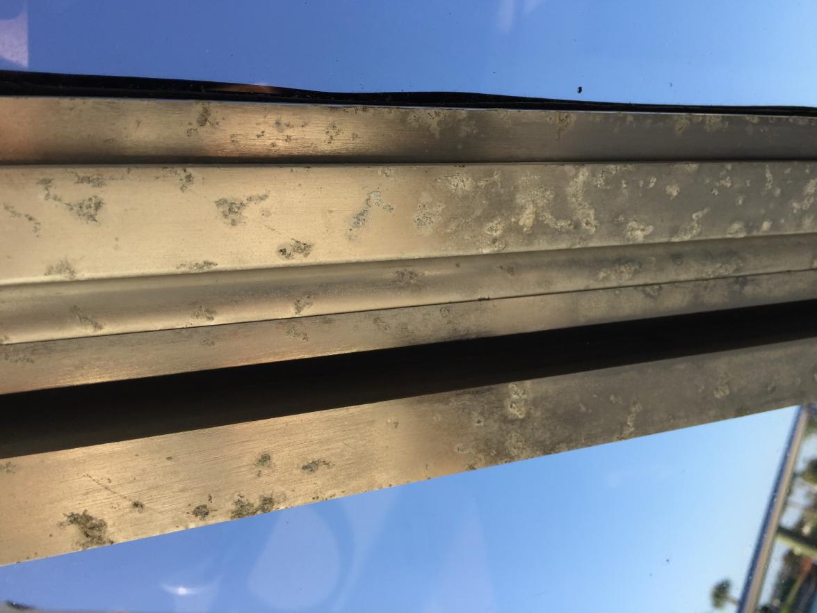

I am trying to clean up some old oxidation on the aluminum window frames of my Sceptre. Was thinking steal wool but don't want to do more damage than good. Any experience with this out there?

Try Woody Wax and BRONZE WOOL, NOT steel wool. Woody wax packages a kit for just this type of project but you will likely need more bronze wool than is supplied with the kit.
Once done with the Woody Wax/Bronze Wool process, then hit the aluminum with Flitz paste applied by hand and polished off with the Flitz buffing ball attached to a drill. It will not look like brand new but will likely be as close as you can get. Good luck.
