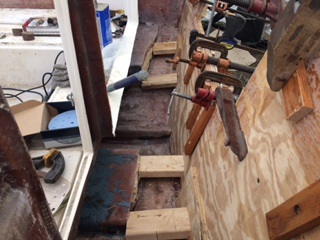

Glued and Screwed Two pieces of 3/4" Marine Ply than epoxied the outside... Glued/West System Epoxied to outer shell, it has no dried and we will glass it in.. More Pics to follow after the weekend. We have also completed the whole cap of the gunnel on the MA so hopefully we will have that put back on as well...
