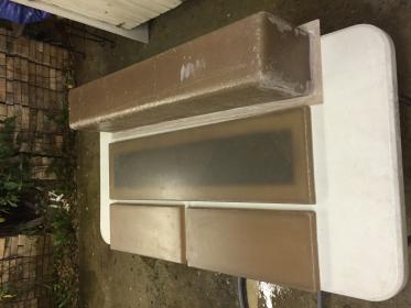

Used foam and scrap pc’ss Worked fine on these hatches

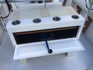

Finished leaning post tackle station
