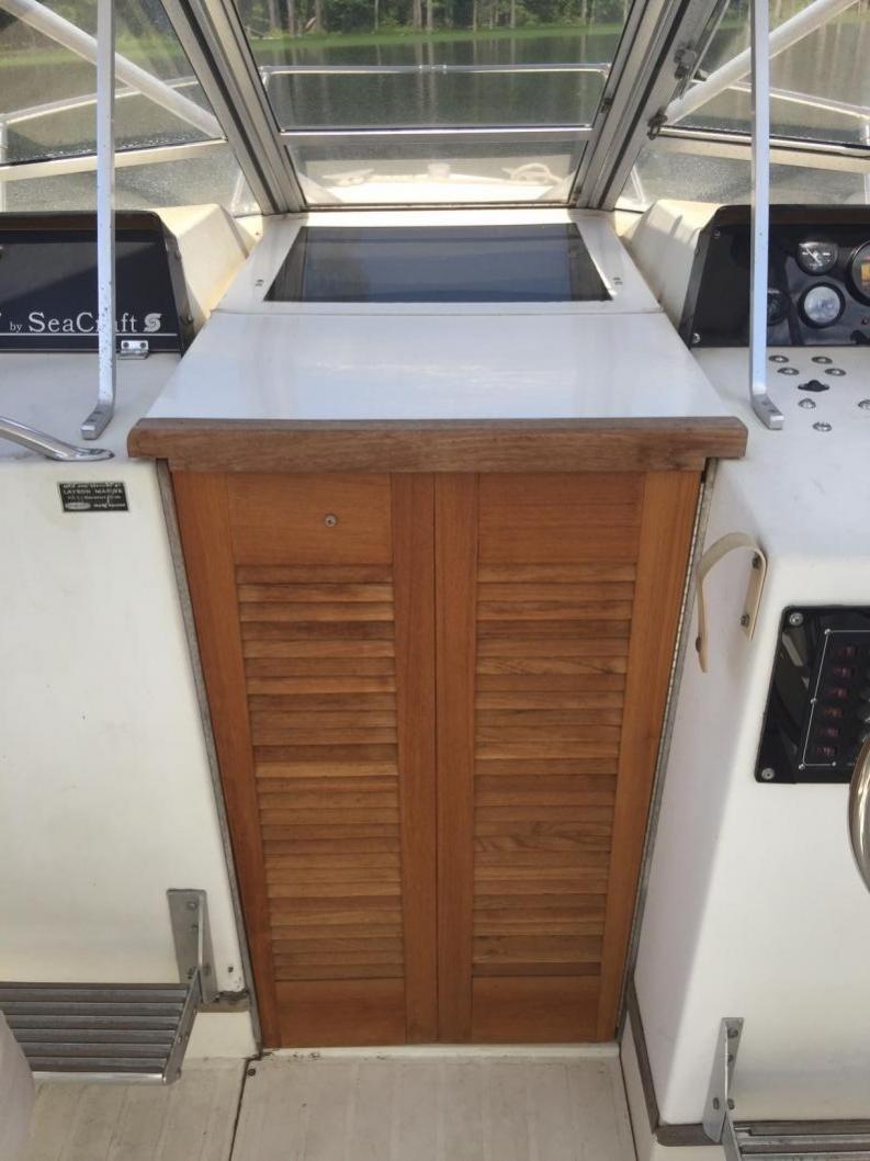

Hi folks,
I am rebuilding the Cabin door and hatch into the cabin, We have the original Teak door and have built a new door but we do not have the top 2 piece Hatch to use as a template.
I was hoping someone with a similar boat could measure the 2 hinged top hatch pieces for us and send me the measurements so we cut the 2 pieces correctly. We are using Starboard for the rebuild. The most important item is where the hinge will go so the front hatch can fold back over and lay down flat without the windshield stopping it.
Any help on this would be appreciated.
Cheers,
Johnny
Old 05-14-2019, 10:36 PM
The front Hatch piece with the plexiglass panel is 24" long. The further aft piece is 16" without the Teak header trim piece.
Thank You very much, that will be very helpful. JW

JW, I checked my back yard and didn't find the hatch. I gave all of my old build stuff away. Sorry.
No problem, We were able to build a very nice replacement for the door and hatch, once completed I will post up some photos
Building the replacement rod holders now and building out the dash to accommodate a 16" screen.
Painting almost done
Thanks for looking
