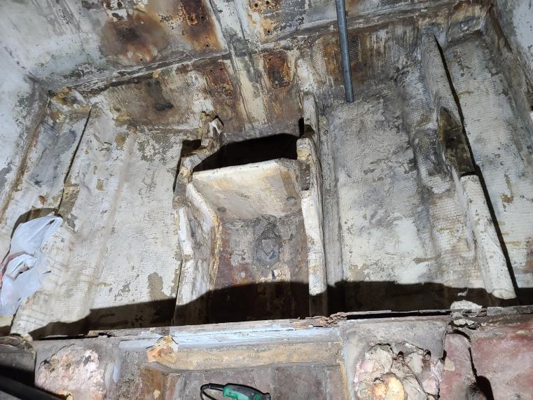

Hey all,
I just started a rebuild on a 1983 23 center console. While I was expecting foam cored box stringers I found these heavily glassed wood stringers In the rear section. I am going to replace them with coosa blue water 26, just wondering if they were factory or done after the fact. Thanks!

Not Potter built Stringers. Could I see twin I/O markings on the inside transom? What is your hull ID Number?

I know the hull was built by seacraft industries . So definitely not a Potter. I will have to look at the HIN when I get home.
Definately looks like an IO conversion.
I would check the transom with a moisture meter and hammer before replacing. May have been replaced already.
The repairs look amateur so.... check things carefully

I am tearing everything out, transom is shot.
