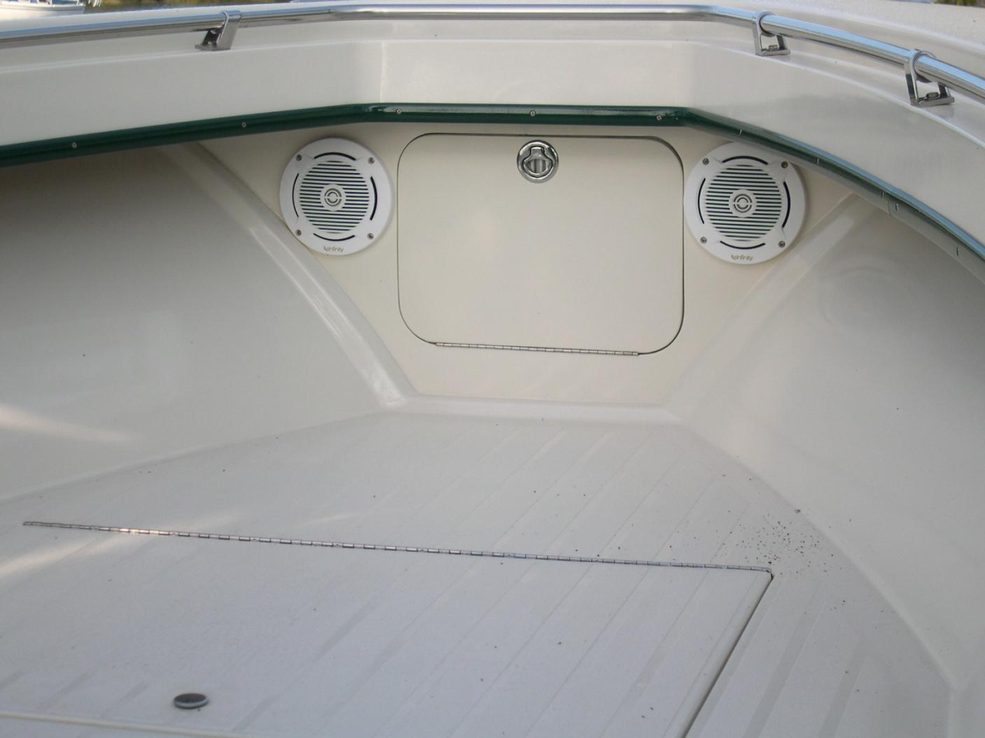

I picked up the trim at the marine surplus store in Ft. Pierce. It does not match well, but I plan to get coaming cushions covers around.
Two Coats of Signature Finish and Wham Bam Thank You Mame
