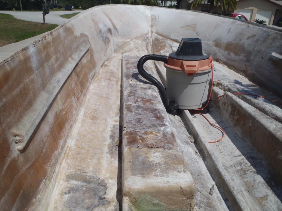

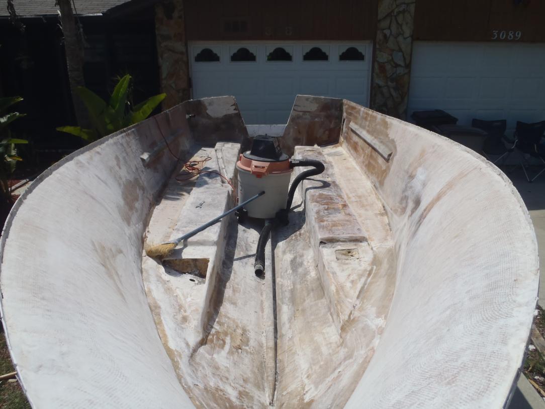

got some more sanding/grinding done today, but damn it was hottt!!!!!

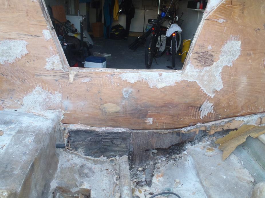

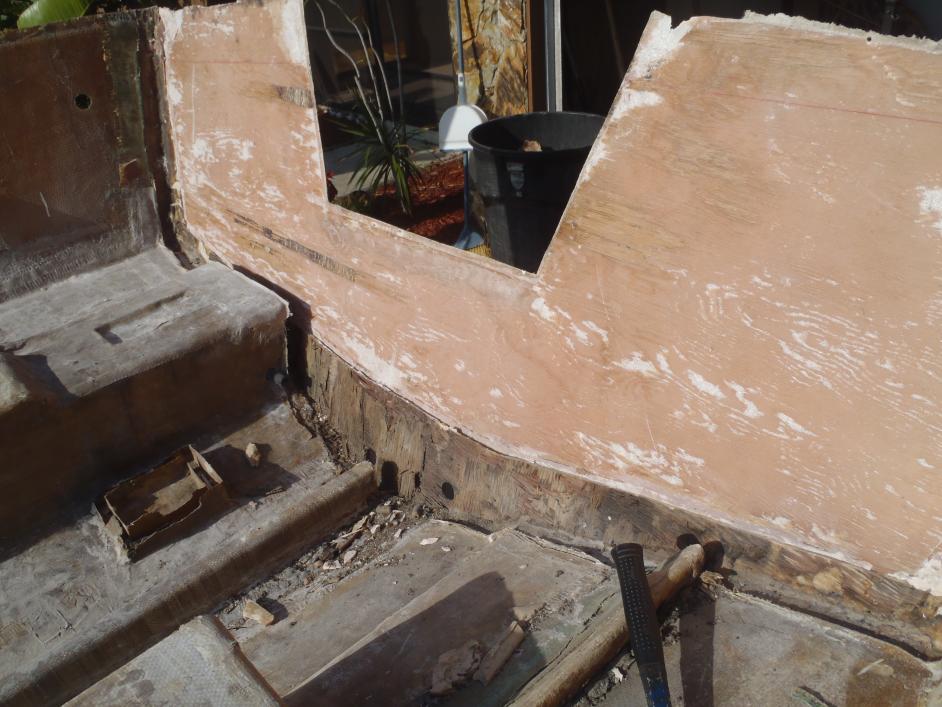

got the transom out last night. Looks like about 80 percent of it was replaced but the old part near the floor was very rotted and am glad i am replacing it. the wood stopped about 1 food from gunnel and was filled with foam. i am going to put the new one all the way to gunnel and floor all around
