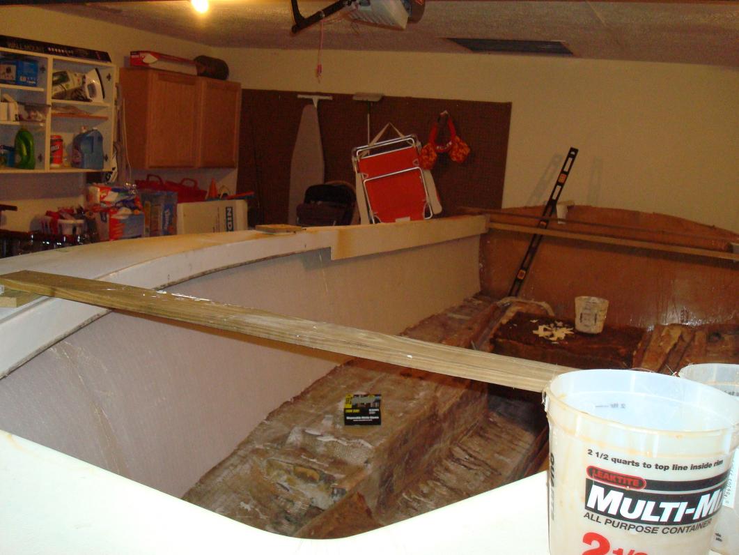

I dont know if i am seeing things or i amjust crazy , but okay it has been acouple months since i cut stringer and hull apart and out.. As i was backing out and looked at the bow it looked like the keel to bow point was a bit twisted . I have heard that you need to keep tension on the bow eye. But didnt think that the hull would actually twist in that manner .. Has anyone experience twisting in keel

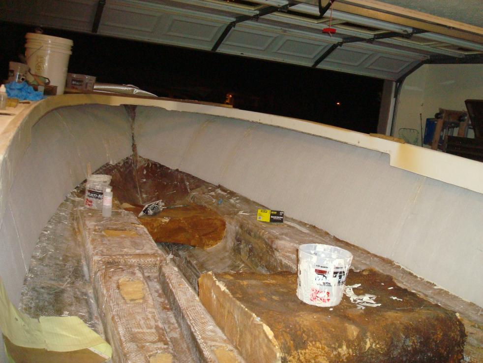

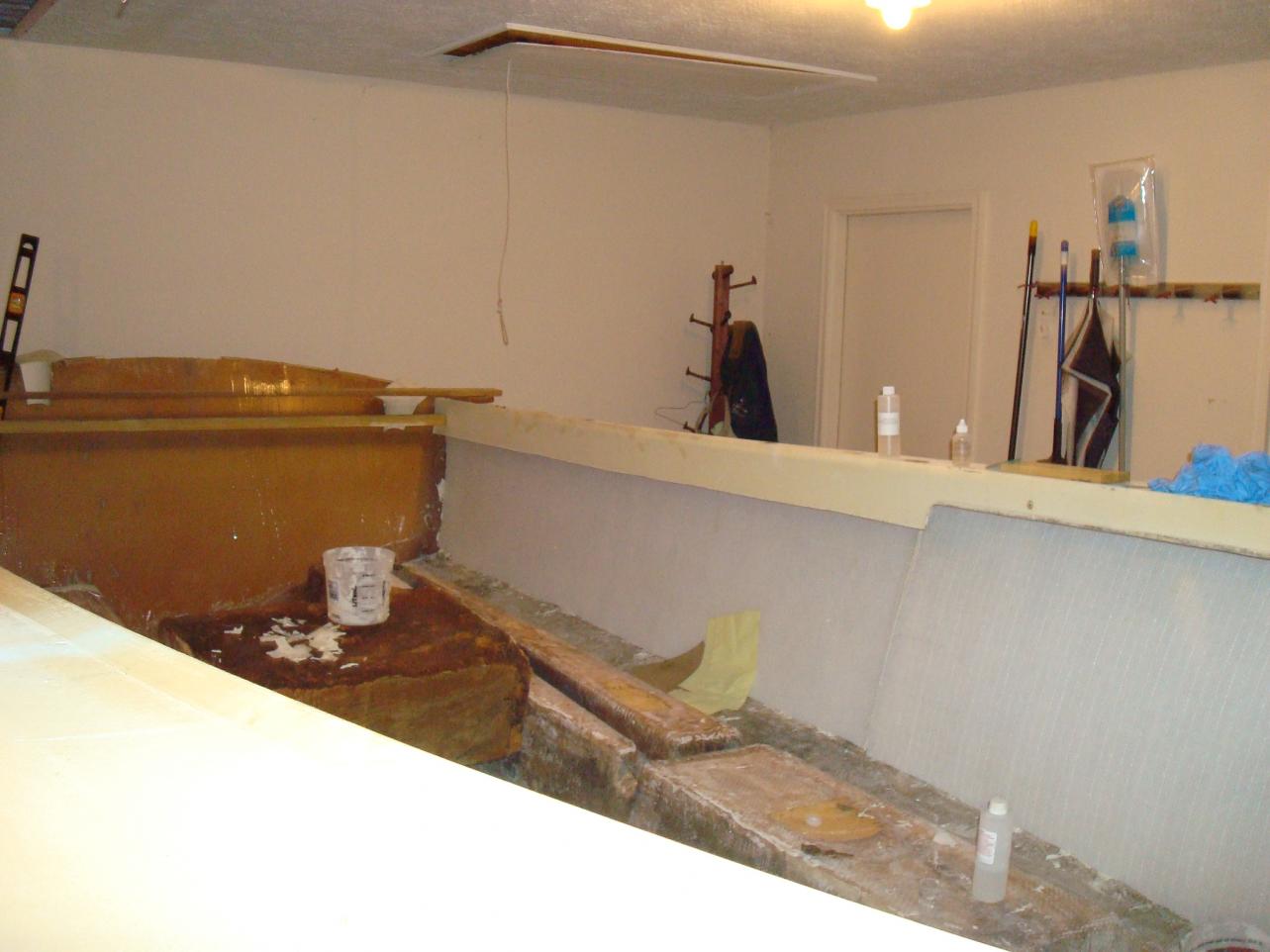

I have nida cored the sides of hull and built up the keel.
