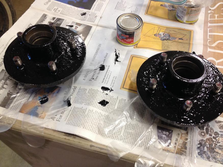

Well, took apart the major parts on the trailer and looks like I'll be able to get away with just a new set of rims and tires.
Cleaned up and painted the hubs, bearings and races look good. Painted everything up with POR-15 paint. New seals going in and hopefully back together next week. Snow and cold really holding up the works.

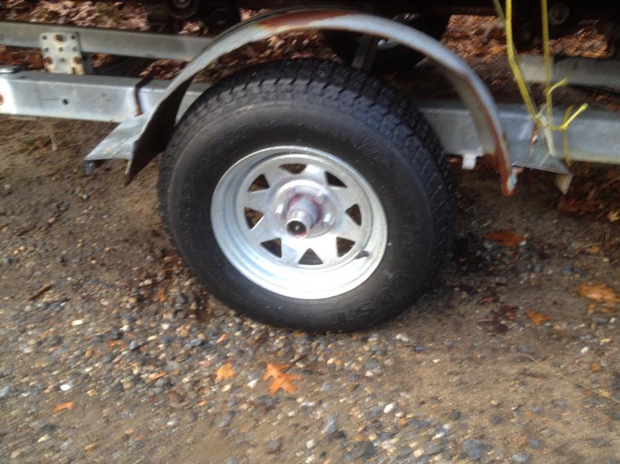

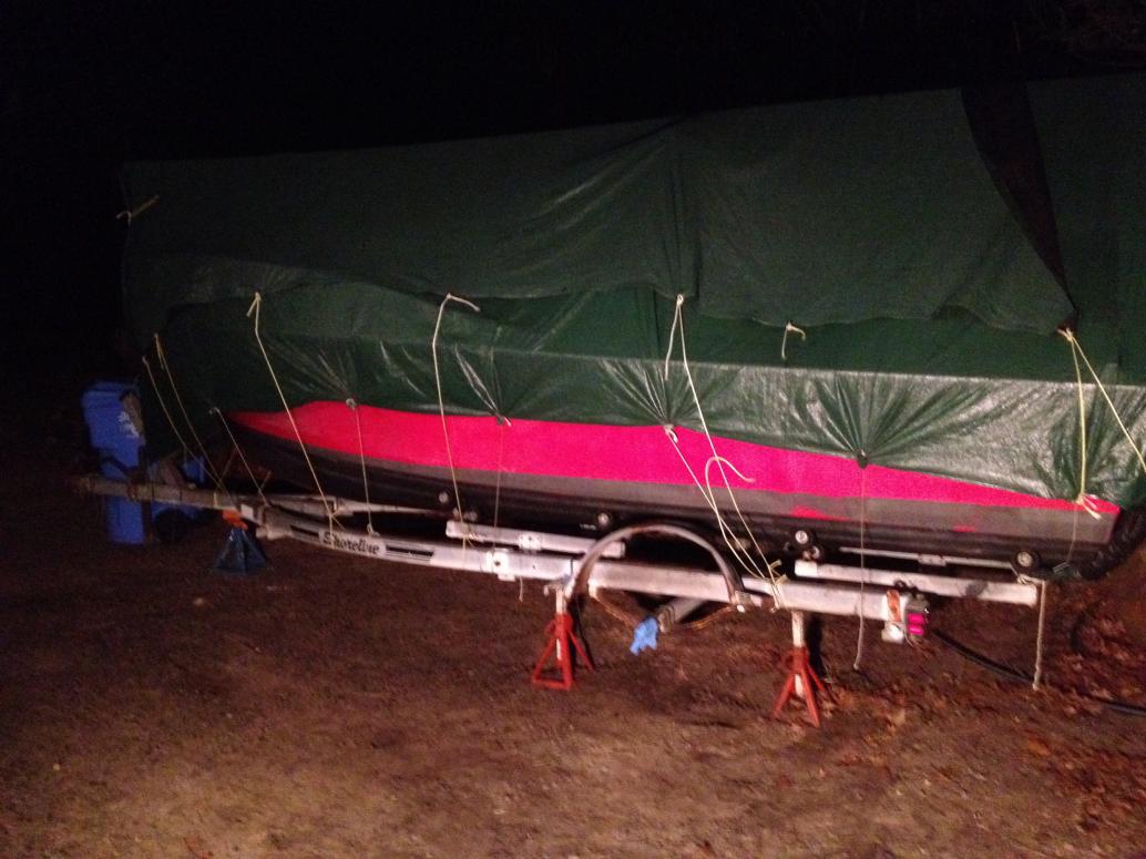

Well, 60 degrees in the northeast today, the trailer is a roller again.
So onto the regularly scheduled program. Plan is to get the boat inside and start demo on Friday, we'll see. Stay tuned.
Maybe after the boat is finished, I'll treat myself to new fenders for the trailer.
