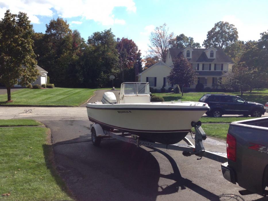

The beginning

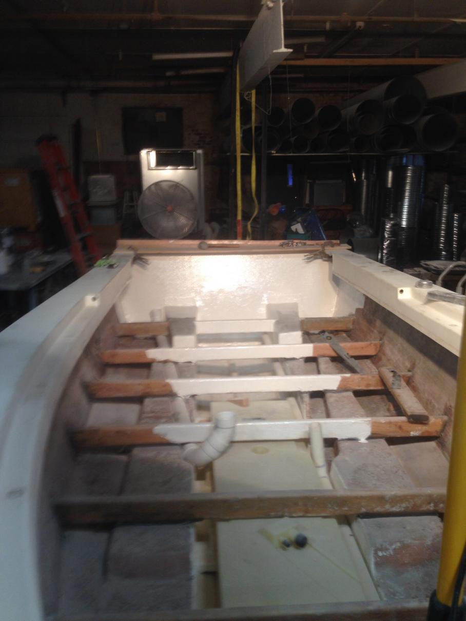

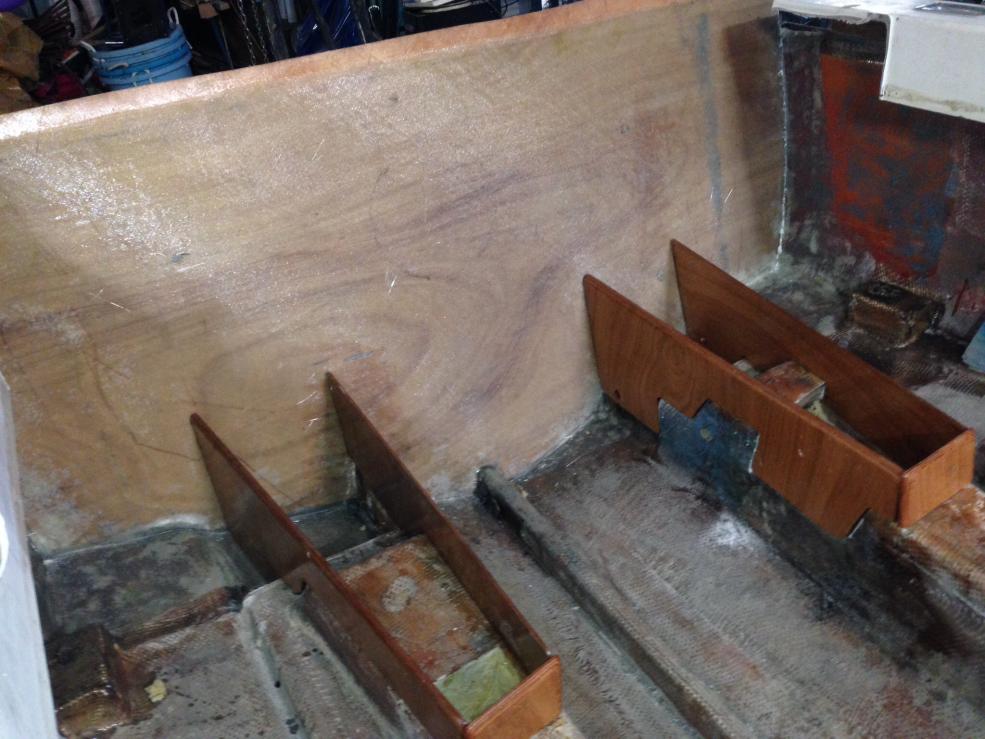

Default Starting the transom rework
Getting the transom rework started along with the stringers

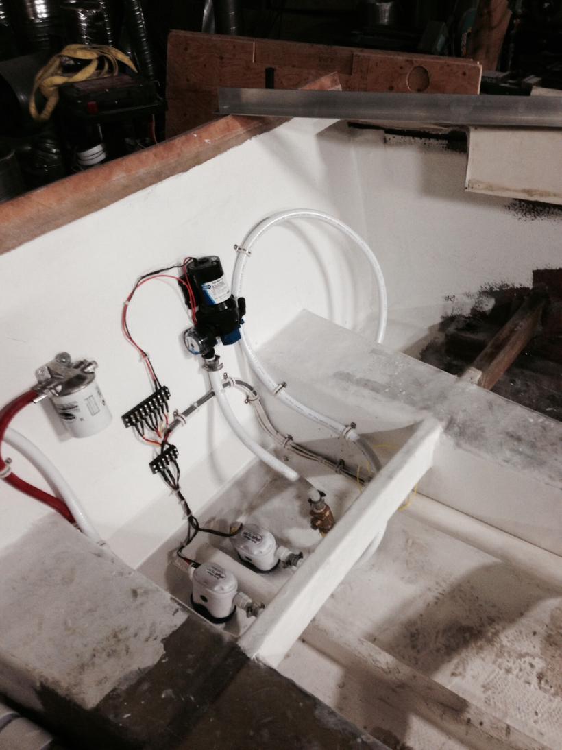

Next we finished the rigging of the pumps and salt water wash down and got ready to re install the floor using Coosa board

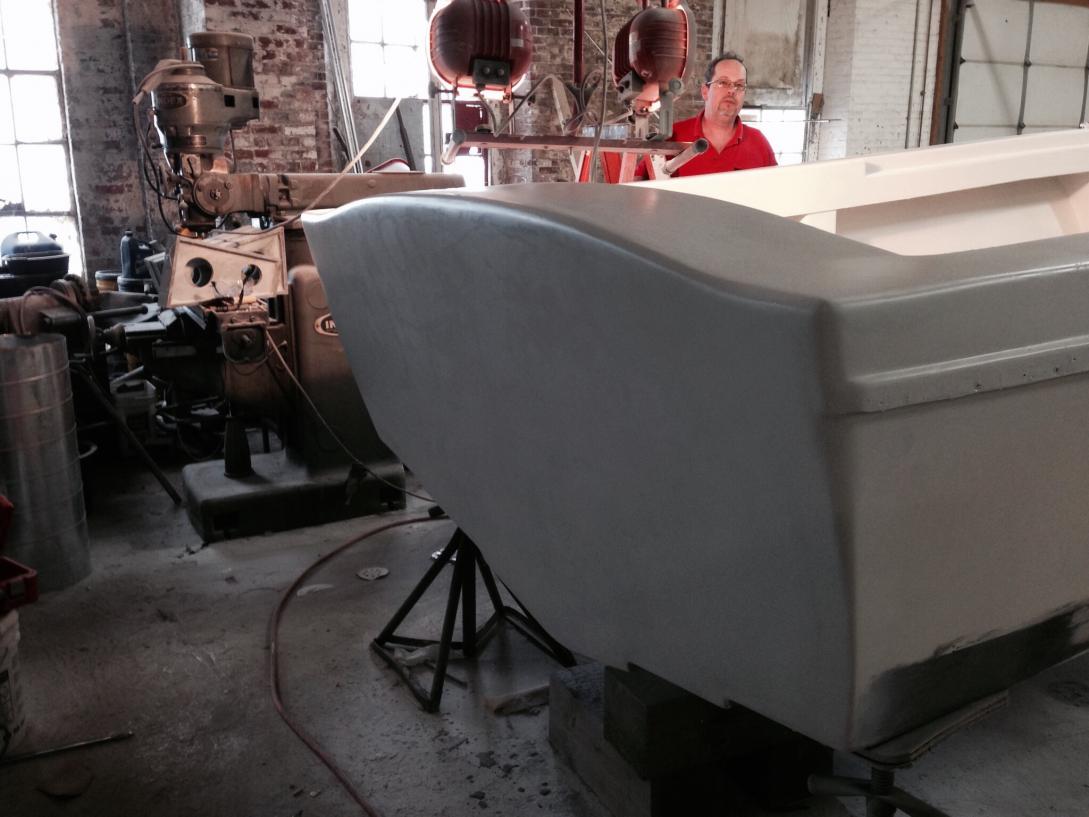

We then went to work on the gunnels and reworking the transom. We really liked the radius look on the transom. On the gunnels we sanded everything down and used fairing compound to get rid of the rough carpet look and give the boats finished look.

Transom after several coats of fairing compound.

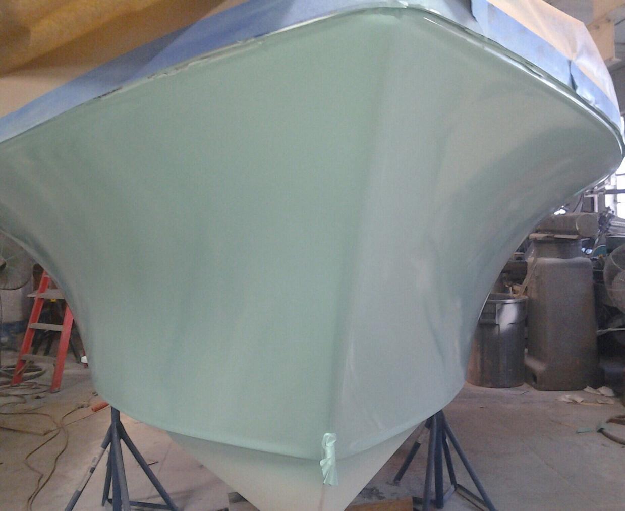

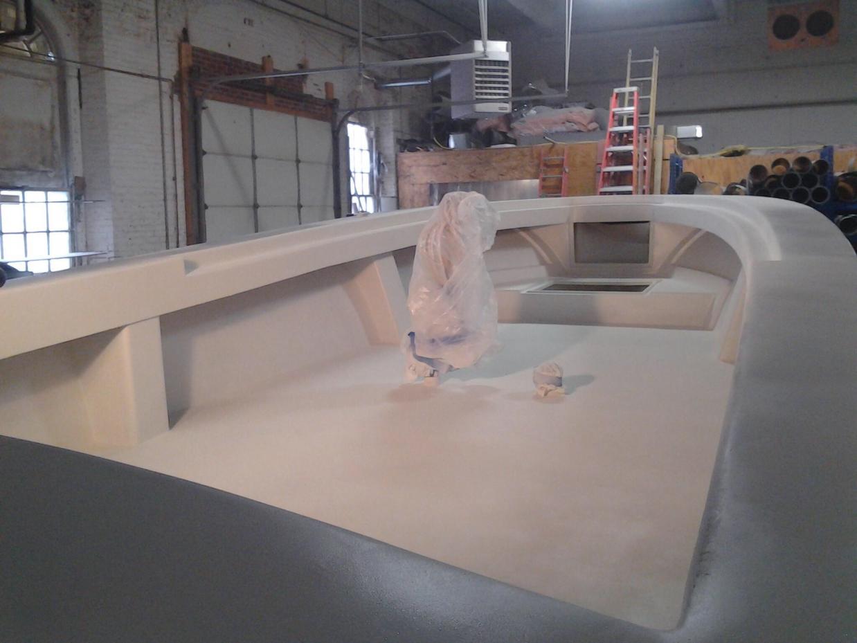

So after two and a half months of non stop sanding and cleaning and fairing we finally got the boat sanded and ready for paint this past week. We decided to go with Imron over awlgrip given our past experiences and also given our experience spraying Imron vs never spraying awlgrip. We are beyond happy with how well it came out.

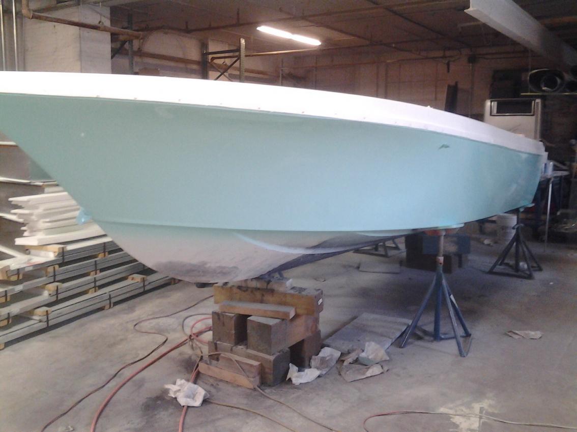

More of the hull
