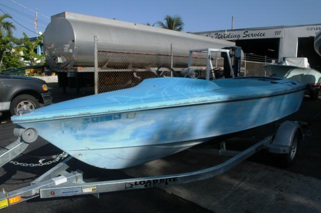

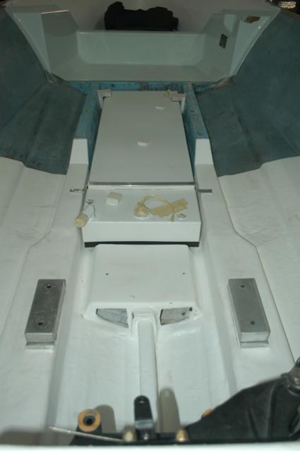

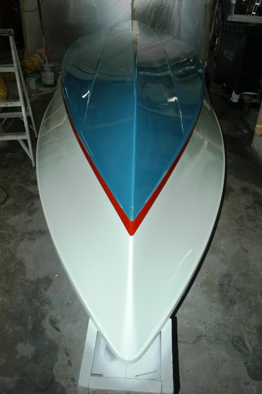

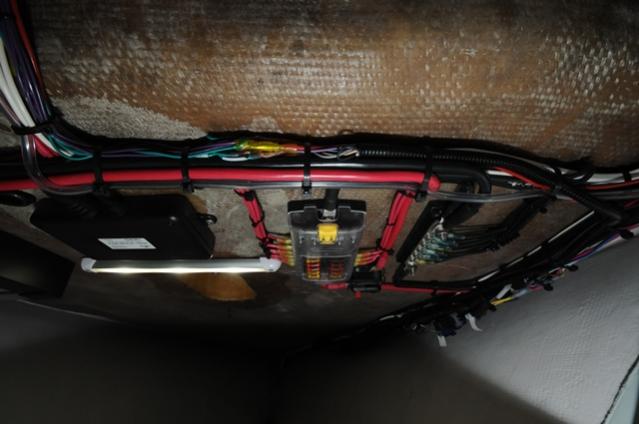

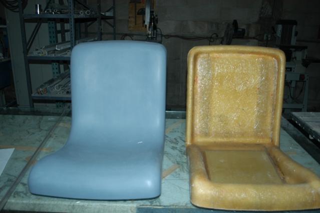

1970 SeaCraft Scampi Re-Store Specifications.
LOA - 15’ 2”
Beam - 74”
Engine - Mercruiser 3.0 TKS 130HP, Alpha Drive, 14 ½ “ x 19” Prop
Fuel - 19 Gals Aluminum
Top Speed - 47 mph.
Paint - Awlcraft 2000. Ice Blue, Petrol Blue, Vivid Red.
Gauges - Livorsi
Controls - Livorsi

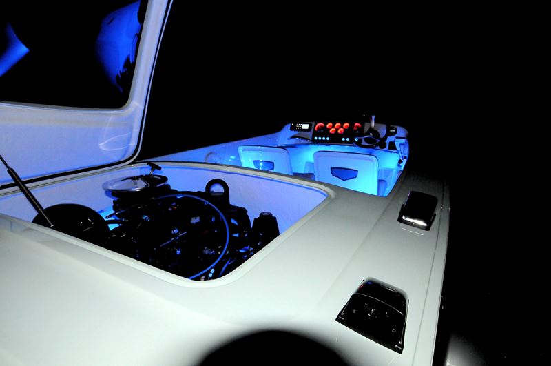

Dash Panel - Custom Silver Carbon Fiber with backlit LED and BEP switching.
Wheel - Edson, Alamag and Varnished Teak.
Electronics - Fusion IP600G with Bluetooth, wired remote, Wet Sounds HT4 Amp, SW605-W Speakers, 8” Bazooka Tube Sub.
Lighting - Lumitec, Perko, Innovative Lighting.
Batteries - Odyssey PC 1500
Wiring - Pacer
Trim tabs - Lenco 9” x 12” with Tactile switch.
Hardware - Premier
Rub Rail - Mate Sphaera 316 SS.

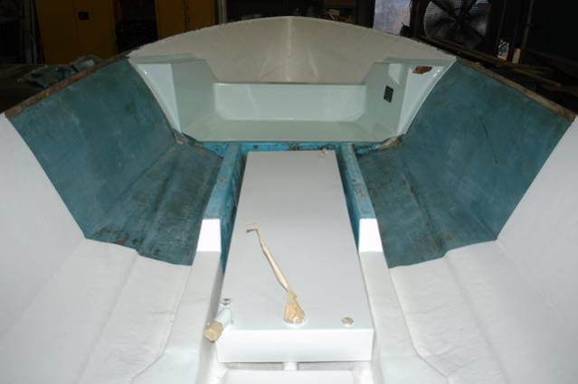

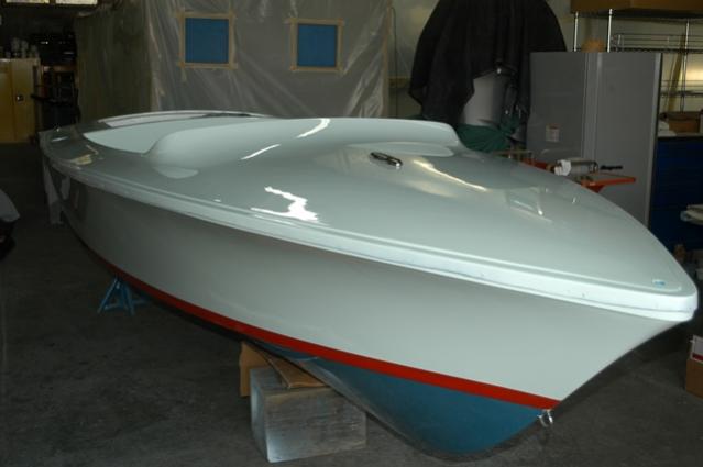

Boat was completely re-stored from 9/2013 - 4/2014.
- Cap was removed. Transom wood was replaced with Coosa Board Bluewater 2600. Stringers in the engine mount areas were cut and in-laid with G10.
- New Aluminum fuel tank, marine tinned wiring, electrics, etc.
- New Mercruiser 130 hp engine.
- Mold’s had to be constructed for one-off fabrication of the seats and engine hatch.
- Boat was completely painted with Awlcraft 2000.
- Custom Plexi “Bubble” for engine hatch.
- Custom Teak flagpole with LED nav light.

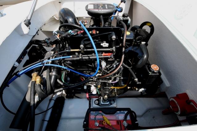

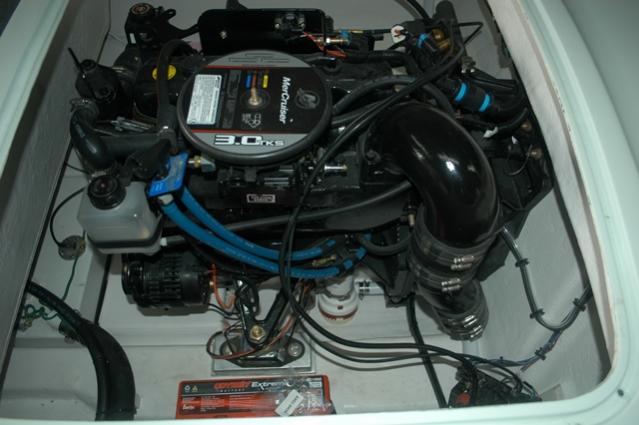

  #125
Old 04-26-2014, 07:14 AM
ian_upton ian_upton is offline
Join Date: Jul 2009
Posts: 15
Are the engine mounts custom? I used to have a 3.0 in an old Bertram, but they had a forward mount.
Ian.
  #126
Old 04-26-2014, 11:57 AM
Join Date: Aug 2008
Location: Ft Laud, Florida
Posts: 771
Ian.
The mounts are an option.
