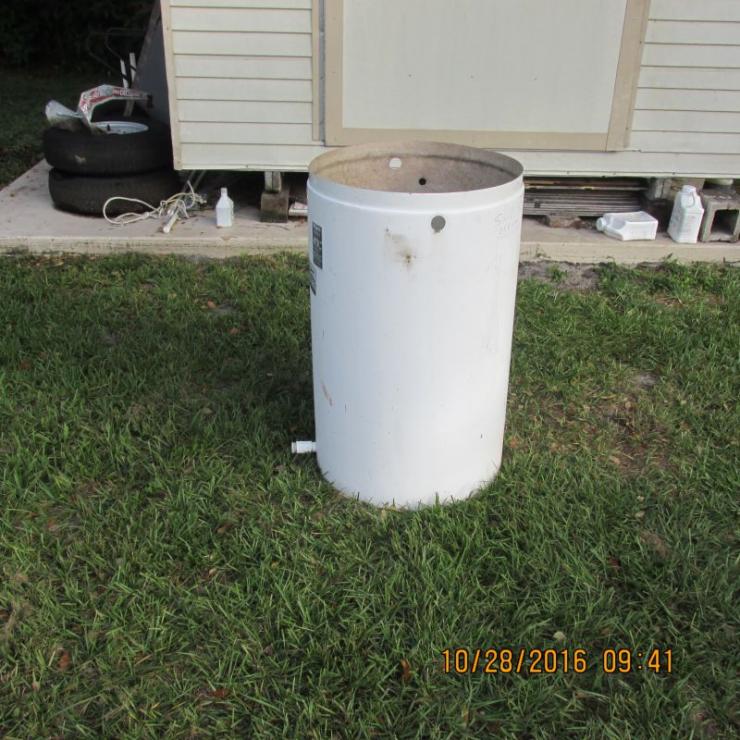

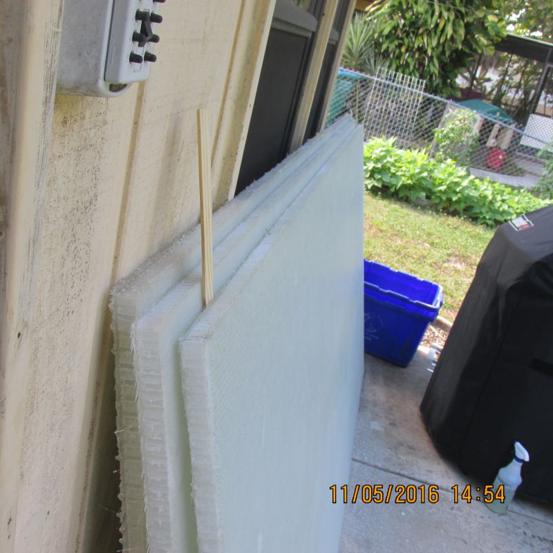

Picked up a water aerator tank this week and plan to repurpose as the live well. It will need to be beefed up some with mat and csm. The nice thing is at the end of the day I can open the drain and empty easily.
Still laying up boards so no great progress on the boat to date.

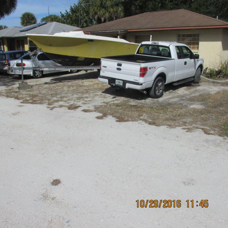

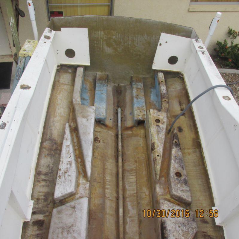

Still skinning boards. But finally got the girl home and will do the clean up today. This Thursday will start to remove the wood transom and hope to get the new one in place. It's going to help a lot now that I start a three day work week.
The Happy Dolphin looks so small next to the SC.

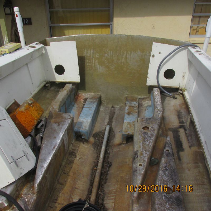

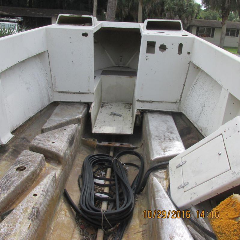

Question, the boxed style stringers in the bilge area at the stern, those are hollow should I enclose them and foam fill?

Natecert,
I believe the two box-style stringers in the transom bilge area are the original engine beds from when the boat was an inboard/outboard. When I had my transom redone recently on my 1978 23' Sceptre I/O, we found the wood that was laminated into these for the engine mounts to lag into were totally soaked and rotten. My advice would be to drill a sample out of them and see what lurks inside.

Water Rat, thanks I totally missed that they are rotted out. Just may remove to give more room in the bilge. Likely will be a bit busy there with multiple pick ups and pumps etc.

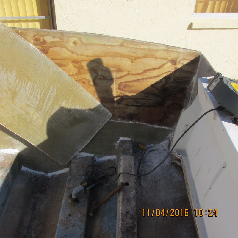

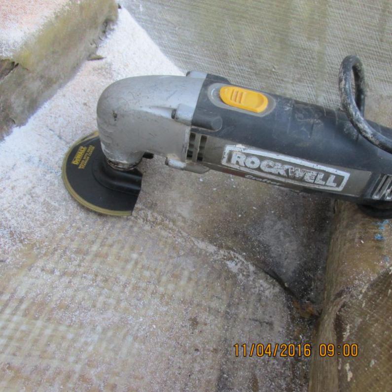

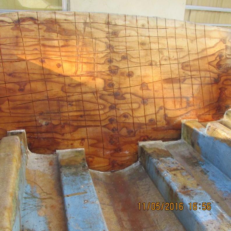

Finally got hands on the boat instead of ancillary items. The inside skin is coming off easier than I though. The used Rockwell tool and blade used for wood/nails made a big difference.
Now that I know the two box frames in the bilge are not structural they will be removed for more space. I started on them and it will be more work than it looks, a lot of glass in there.

Removing the wood is more of a project than I thought. Going to borrow a chain saw and see if that helps. Taking the most of the day off to do on line tests for the CEU'S i need.
Made a run to Fiber Lay-Sarasota on Thursday and again Ryan was a big help also found a way to discount the bill $50. One more board to skin coat and they are done.
