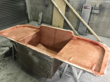

I saw on Stoner Boatworks' Instagram page what might be your bracket under construction. Yours??

Really? Here is mine....
