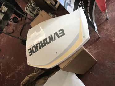

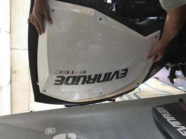

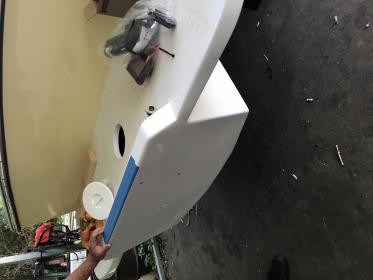

Well, I found out the hard way today that I need a 30” motor. Thankfully evinrude was awesome about it and they are exchanging the motor. Another week and it will be finished. Here are some snaps from today’s visit.
