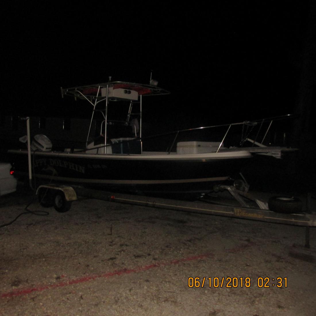

Default Dirt
Same here.
Got the non CSC ready to go for a three hour tour if ya know what I mean. It'l be one of those 150 mile days on the left coast, leavin the dock @ 4:30. And yea it twas a pleasure. You are a master of glass work that I dream to be in the next life time.
