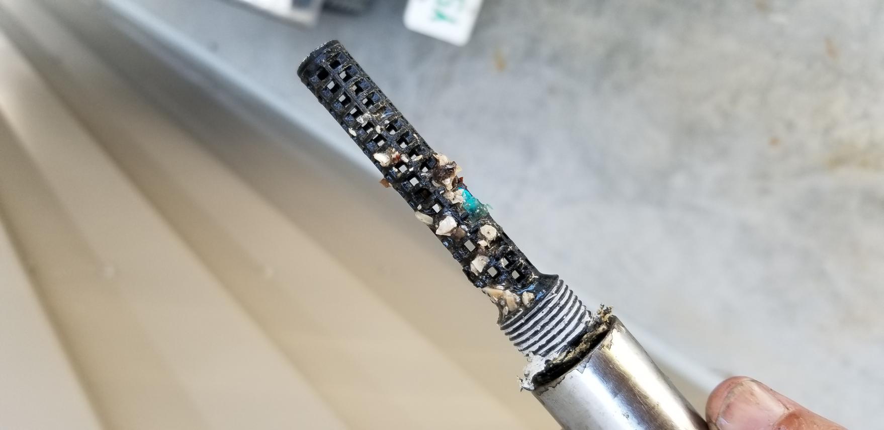

Update: after replacing oil tank and poppet valve with no success decided to take it to the pros to get the computer read. Turns out no codes and the motor only has 600 hrs on it!
Culprit is a inline filter behind the oil tank which cools the computer....pic to follow.

Pic
Old 11-04-2018, 12:01 PM
Dang Robert that's ugly!! Gotta ask what is all that crap?

Ha! yes sir...Mostly shell and a bit of ice bag...….

lots of guys dont even know that filter is there...on my 2015 optimax 200 hp, part of the lower case has to come off to check it..pita
