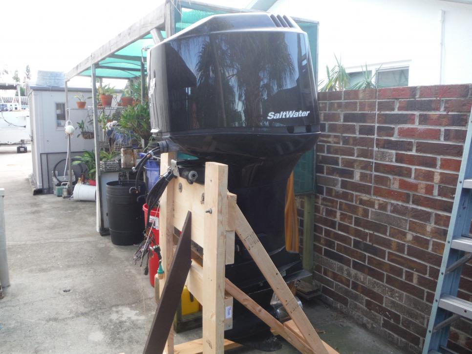

Hey Terry, he's the latest engine stand I made out of wood. Maybe it will be of help if you decide to make one. It's on casters and I could move it around easily. I had some extra wood so I made a few extra braces....just in case. The guy who bought the engine rolled it up on a trailer just as you see it, strapped it down and off he went.

Thx DonV-
Your stand resembles what I completed a week ago. Awaiting good weather to pull the ETEC. Like jet engine or gas turbine design, nearly every new design relies heavily on its predecessor. Maybe I'll add that forward brace like yours.

Naw I think you're good!!!! You went above and beyond with metal corner brackets. My Merc was 505#, I used the same bracket for a neighbor's Honda which was 610#, I don't think your eTec will be up there. 3" wood screws are bad to the bone, take it apart, save the wood and you can use over and over.....cheap bastard I am.
