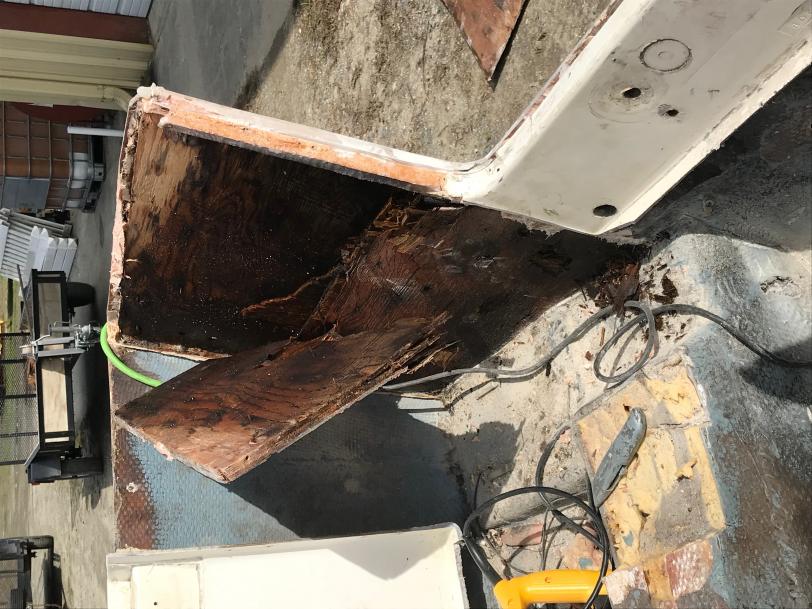

Keep your eyes open. Boats that have been redone fairly recently do come up for sale.
http://www.classicseacraft.com/commu...1&d=1594119183
A little snapshot of mine.
