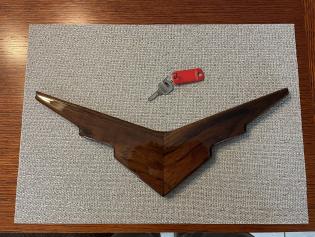

Little jobs until the cold weather passes- 16 deg this morning…
Window dressing for the anchor locker divider in the cabin from recycled teak / old swim platform.

Nice job on that... how'd you cut it?
Would like to have cut it on cnc router but went with what I have at home. Just printed half at full scale, traced on teak, then cut close with a jig saw. Then came behind with belt sander/ sanding disc / sanding drums to clean it up.

Have a flush trim bit? Once you have a pattern like 1/4” mdf you can crank them out.
If not pm me.., I have.
Btw teak looks good. Using petit flagship?
I know what you mean but this was just a one-off on recycled scrap teak that was run through a planer to get rid of weathered bit. Pieces were only slightly larger that the part I wanted so had to split down the center and have the glue joint.
Used west system/ 207 hardener, couple coats, and a couple coats of clear awlgrip. Would do more coats if in the weather but emblem will be in cabin. Chairs were done same way but three coats of epoxy and 5-6 coats of clear.

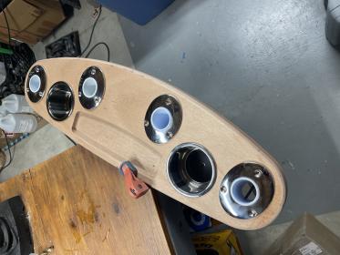

Small 30 in wide rocket launcher for cockpit.

Posts: 95
Painted
