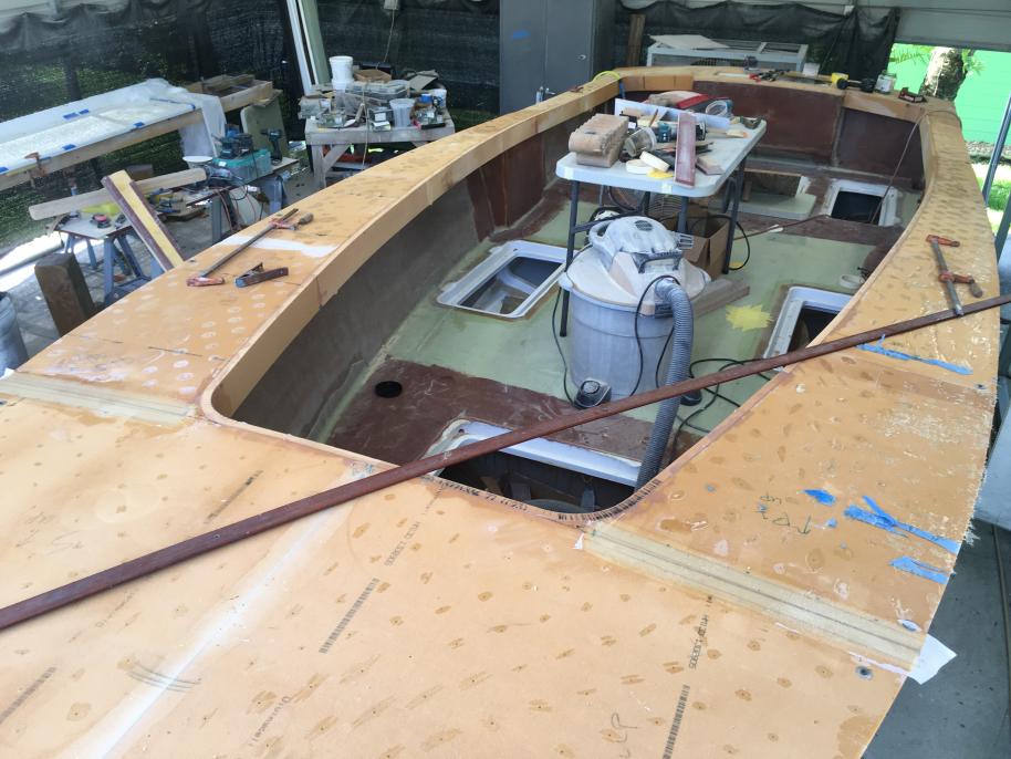

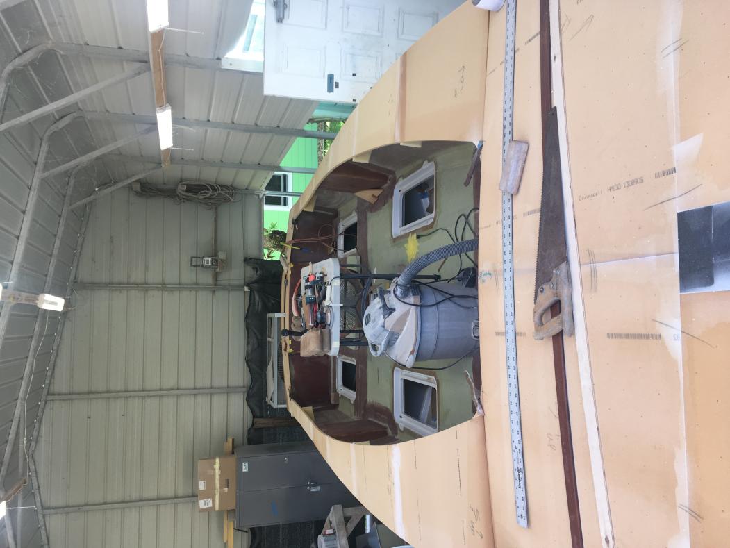

Got a cap on her now...

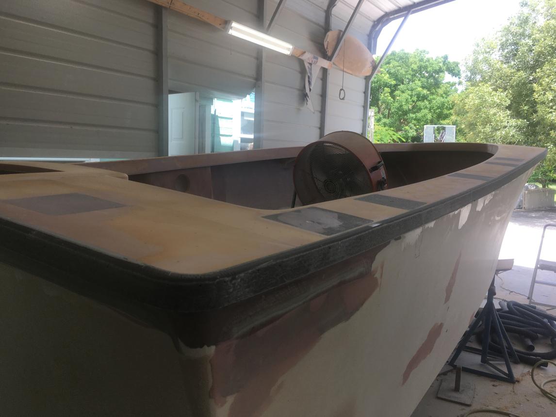

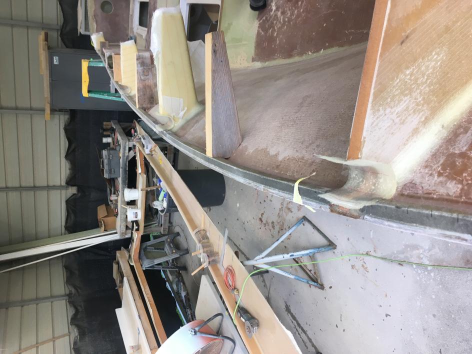

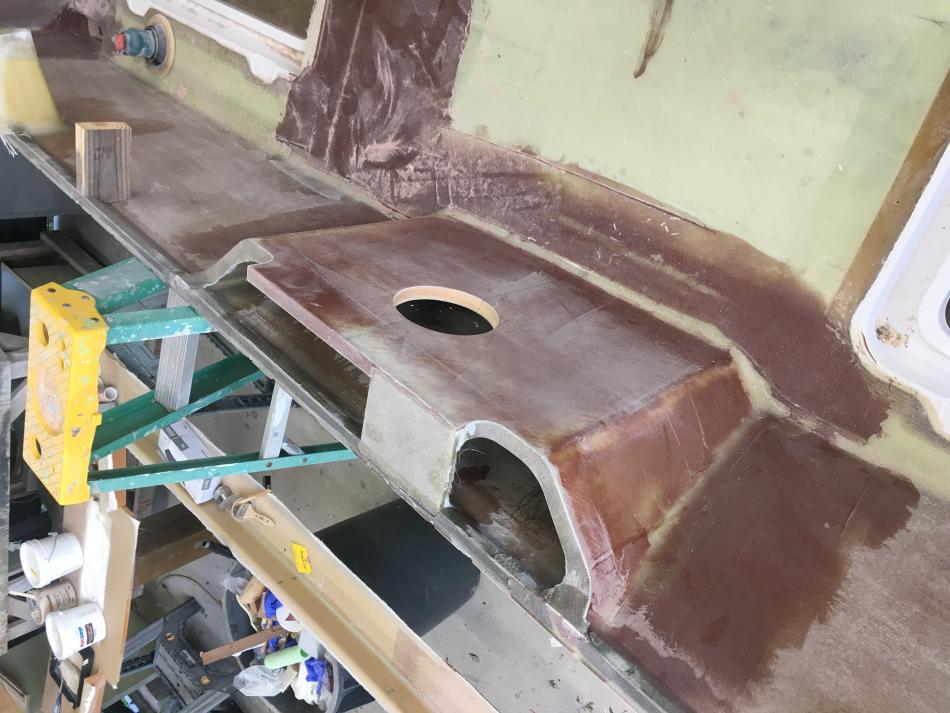

A couple things to notice. Strip of coosa on the inside so rubrail screws dont come thru (nice gluing flange too)
Swivel rodholder backing plate glassed into the side boxes (also a nice glue surface)
Glassed half rounds to run wires thru (i hate when people just drill holes in shit!)

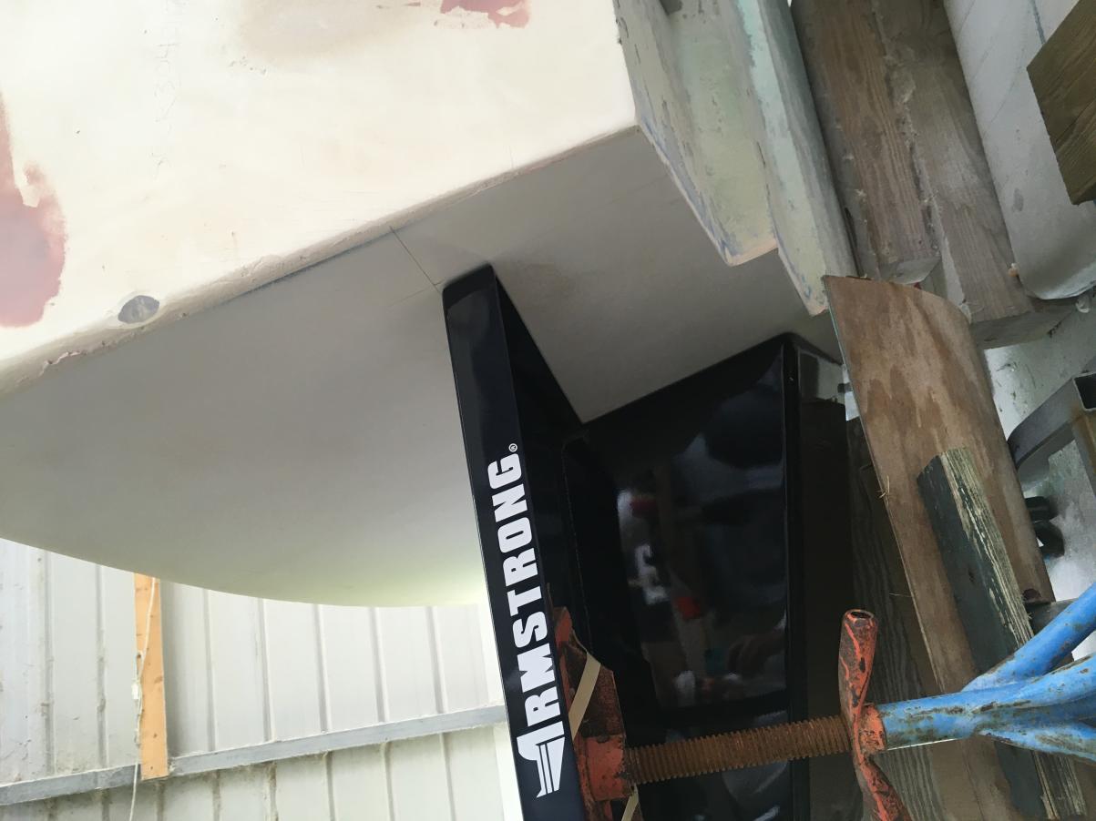

What are they getting for those Armstrong brackets these days?
  #66
Old 07-19-2022, 08:52 AM
Ya know Strick a few years ago I think they quoted me at the Miami boat show right at $3,000 with dive platform....not counting options like ladder, etc.. Oh yeah, that was before the huge increase in the price of aluminum. They told me they had a template just for the 23' SeaCraft and made many of that model. The Stoner fiberglass and Armstrong bracket were almost the same price. Armstrong is REAL proud of their stuff!!!!!
  #67
Old 07-19-2022, 10:31 AM
Stoner is pretty proud of his also.
  #68
Old 07-19-2022, 10:37 AM
I was just a wonderin...seems about right now probably a lot more...almost all I’ve seen have quite a rise up toward the motor...as compared to the mat flotation tub style good ole Hermco used to make.

This one was north of 6k. Its the "tournament" rated to 400horse. Ladder mount and ladder, paint match, and rigging port added about 800$, on top of the 5k base. Then taxes...

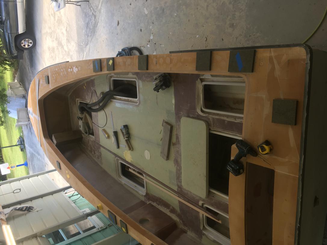

Strick what am i doing wrong with pictures?! Theyre taken vertically on my phone, and are perfect on the computer...
