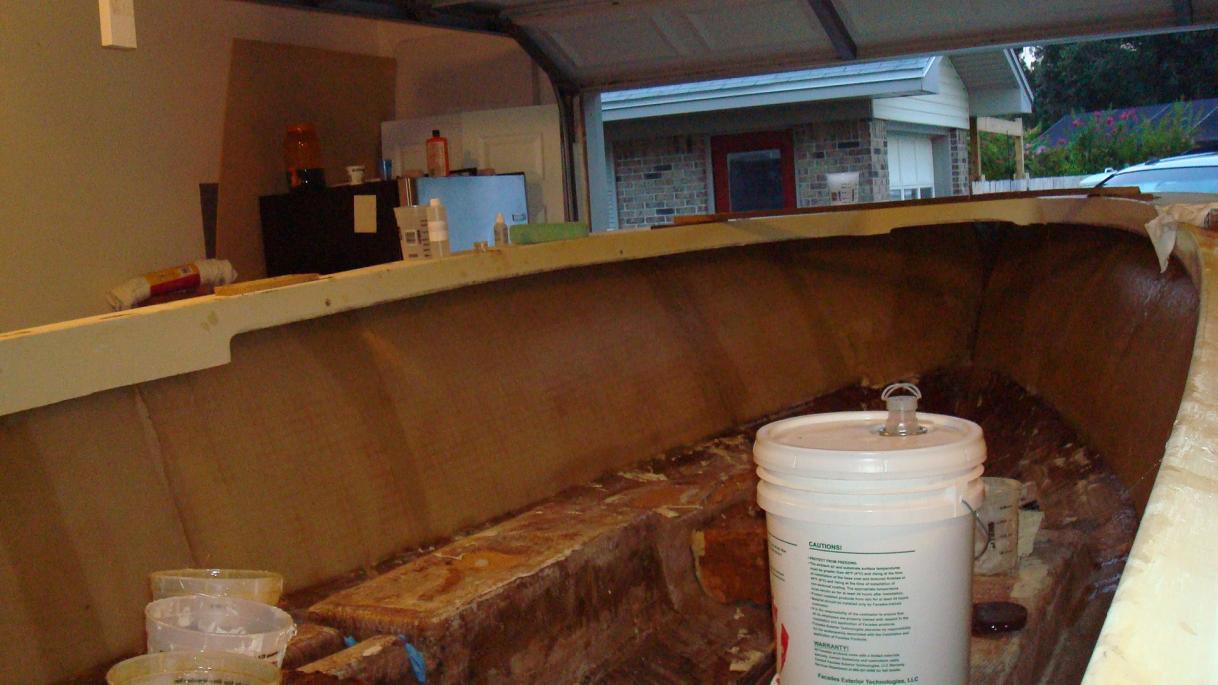

Here I used there core bedding compound. They recomended Vacuum baggin but I could not do it at this time.. So i just Pressed it in the core and then applied it to the hull. then i took a formica hand roller and Rolled the Dog crap out of it.. it seemed to hold very well...

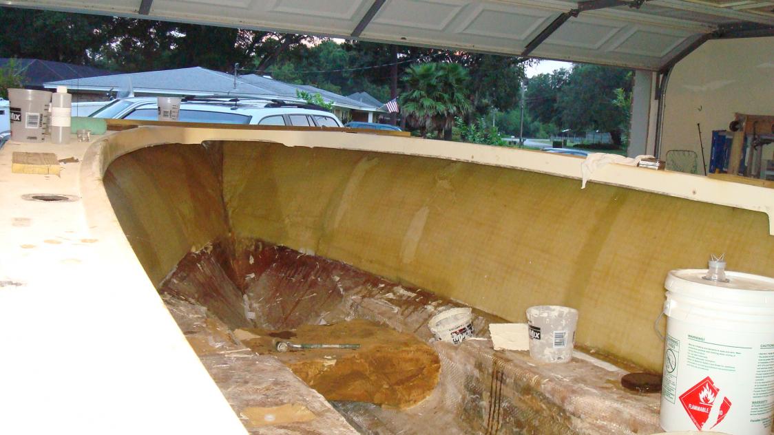

Glassed over the nida core with bi-axial 1708 and another 1.5 oz mat ,,debating on vacuum baggin the last layer so i can get a better finish and not have to fair as much. or maybe just lay a sheet of sheathing over the wet glass and then peel off after the resin sets up. I then started to glass in the keel and get it ready for the pourable material..

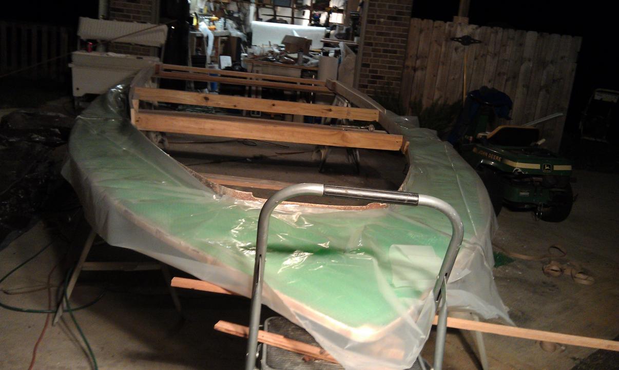

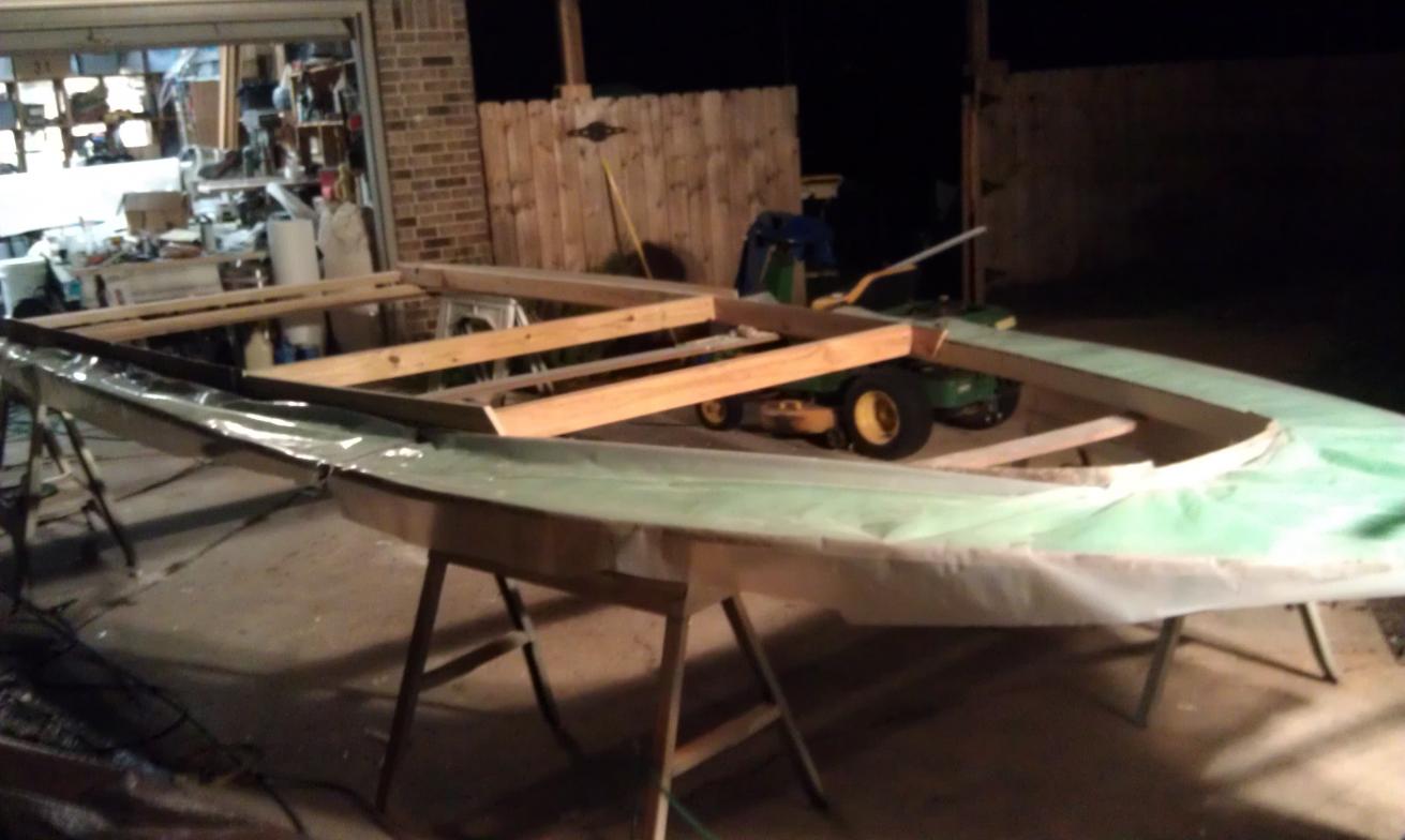

Here i apllied the nida core and am setting up to vacuum bag the glass to nida core
