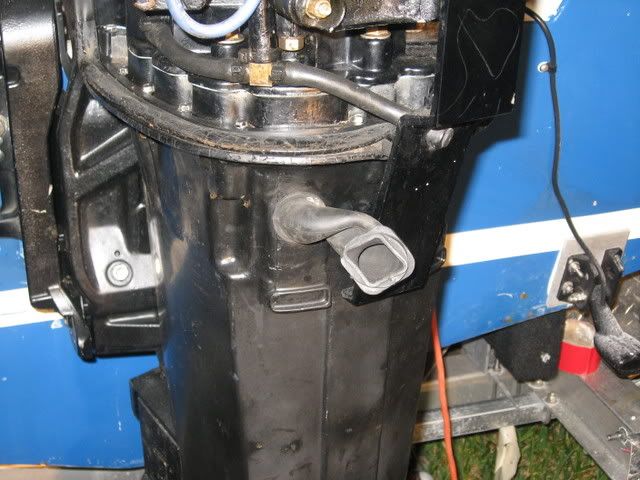

Blue - Serial number for the engine can be found here.
Did you swap either adaptor plate when you mounted the powerhead on the 2.5L mid-section?
I might be crazy here, but it looks like you are mixing adapter plates bottom from 2.5 and top from 2.4L

late last nite S&F posted the same response u did. i know it has 2.4 gaskets in it but as far as the plate and exhaust tuner i have no idea..
Old 06-12-2007, 10:58 AM
Default Re: mercury poppet
Yeah . . . I posted this on there too. 2.4 and 2.5L plates are very different.

so big, before i go to the parts store i want to verify the gaskets i need with u. for the upper plate i will need #29 and 29A?
and for the exhaust i will need part # 24 and 26 and 33? the guy says he can have the powerhead off in about 30 minutes.. or do u think i can reuse the gaskets that are on there? it has only been run 2 times thanks again

What you've marked is correct . . . I've only ever used one base gasket (29 or 29a) under the powerhead, but go by the book . . . I'm kind of a hack when it comes to this You might also be able to reuse 24 if it's in good shape.
The guys right . . . he should be able to have that powerhead off and the gaskets changed out in less than an hour. I would supervise if I were you. Make sure he cleans the surfaces well before he puts the new gaskets on given his history of mixing 2.4L and 2.5L adapter plates.
Also I would recommend getting more than one base gaskets (29 and 29a) Just in case you forget to put the shift shaft back and muck up the base gasket (it'll save you a trip to the store).
