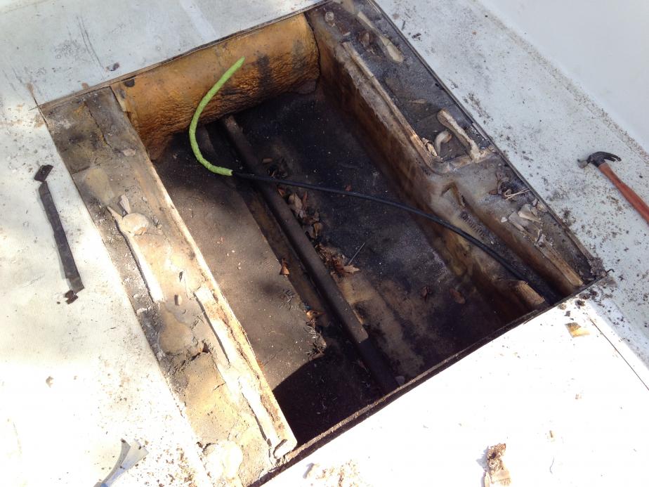

I finally began the tear down. The deck was in poor shape, and my stringers are full of wet foam.
Why did they not seal the top of the stringers? I have several sections of exposed foam on each stringer.
I am planning on cutting the rest of the deck out and stripping the foam out of the stringers. Also in the planning stages for a cradle.
