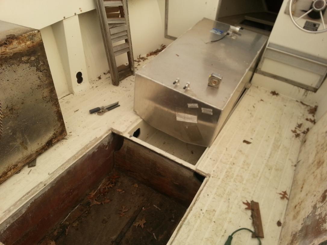

New 82 gal tank

Who did the tank? I'm shopping around for one for my. 20SF.
My 1973 SeaCraft 20SF
Parker 2530 DVEC
Boston Whaler 15 1984
Old 12-29-2013, 10:30 PM
What power are you back with? I saw two fuel pickups on that tank....dual 4 stroke outboards on a Hermco floating bracket?
Old 12-29-2013, 11:31 PM
Location: Fairhaven Mass
Posts: 583
Not sure who did the tank I got it with the boat. Was never installed. As far as the 2 pickups I will be capping one off. Going to be another mercruiser 350 with bravo 2. The tank was made for aquasport I believe, but I fitted it out and is going to work nicely.

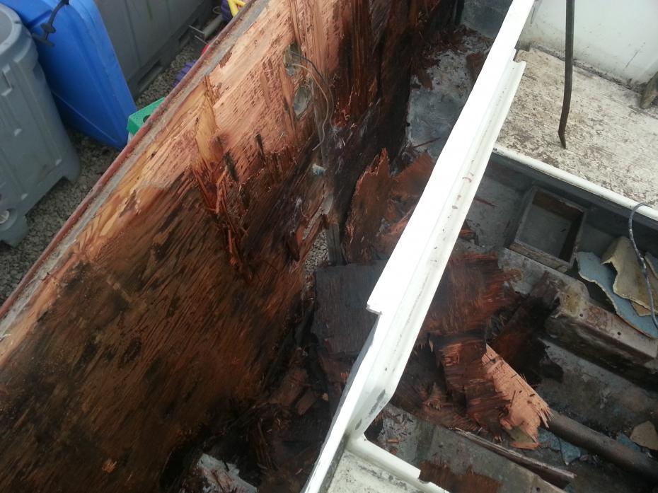

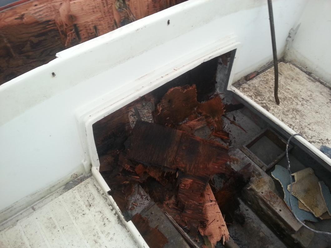

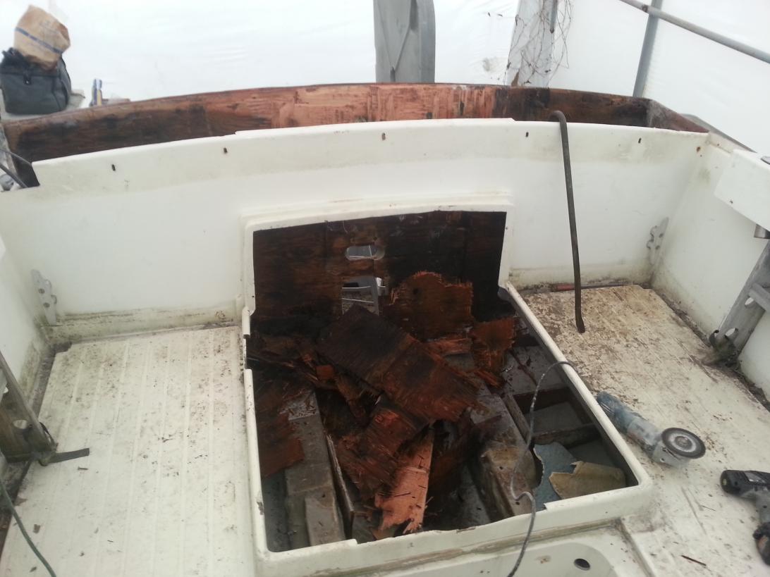

You have a pretty good head start on me so I have a couple of questions to lob at you:
What is the easiest way to get the wood out of the transom?
Is the Bravo 2 just for the bigger wheel or am I missing something?
How far did you get before it got cold? I'm guessing that you will be glassing as soon as you can get it warm enough. At the rate you are going, you will be done before my transom is solid - no race there!
Thanks!
Old 01-09-2014, 02:36 AM
floorboy floorboy is offline
Join Date: Apr 2010
Location: Sw Mn
Posts: 362
Thanks!
I just got done taking mine out so I will answer for him. I used a sawzall, grinder, chisel... Whatever you have to to get the skin off. Then I got a big wrecking bar and sharpened it and beat it down from the top prying layer by layer off. ( you should be able to split the inside sheet of 3/4 off whole). At the end I actually got in between the first layer of glass and the wood and split that layer off nicely. A little grinding and it looked great.
It is not fun though.....
Old 01-09-2014, 07:52 PM
Posts: 583
Its a Bravo 2 cause thats what i have on hand to go in it. No specific reason. As far as a easy way to get the wood out, there is no east way. I recommend to buy a comfortable pair of knee pads before you tackle it.
